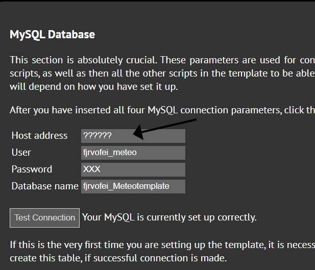

Is there other settings in the netatmo plugin I must set other than (see picture)

Thats right, I upload the clientraw.txt file from Weather Display to a different server than the Meteotemlate is on.
But Weather Display use the Metetemplate API to upload files.
In the main setup in Meteotemplate, the adress to MySQL Database server had changed. Dont know why.
That made the error.
Ir seems to work fine now. Thanks.
