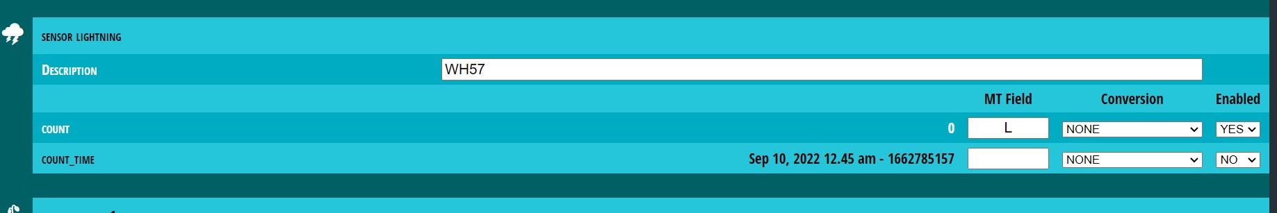

- meteoesine
- Posts: 186
- Station model: Davis Pro2+
- Software: Meteobridge nano

Re: new plugin ecowittNet
I noticed that too, I think this happen when the console/gateway is reset, lightning count is zeroed and last strike distance/time is lost.
You can try this version.
ver 1.3
- added lightning distance/time data ( if not already present )
ver 1.3
- ecowittNet_1.3.zip
- (7.54 KiB) Downloaded 994 times
