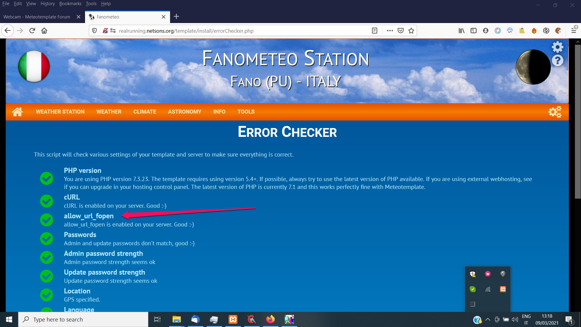

Ok, do not forget to revert to the original updateWebcam.php script ( the last one does not check the password, so is open to everyone, and always saves the snapshot, without waiting the set delay )
Run the error checker ( via control panel ), you should have a red mark in the allow_url_fopen check
If this is the case you'll have lots of problem with blocks/plugins retrieving data from external URL.
To fix this ( permanently ) you need access to the php.ini file, adding
allow_url_fopen = on
( never tried this, found searching for 'php file_get_contents not working' )

@davidefa
Yes, thank you for reminding me!
allow_url_fopen was on in the php settings on the server, but then set off again by en entry in the .htaccess.
My hoster found it out!
