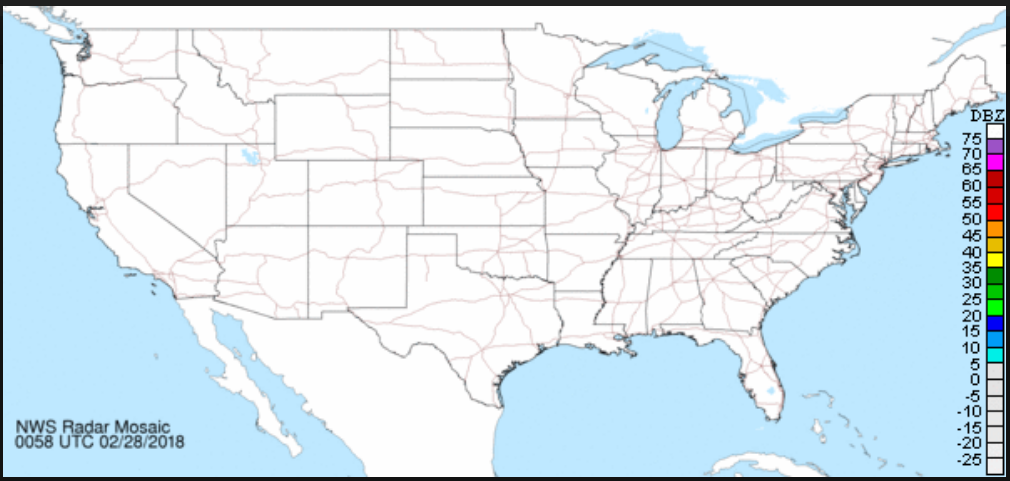

dmgould wrote: Wed Feb 28, 2018 12:32 am US Radar block might be the same issue. I haven't had a chance to check into it yet.
Looks like they managed to break their own site. All the radars look to be down now and I have to think it is related.
https://radar.weather.gov/radar.php?rid ... 11&loop=no
Screen Shot 2018-02-27 at 8.34.05 PM.png (305.6 KiB) Viewed 25111 times
I am curious if the radars go HTTPS too.

Re: US NWS Change Breaks Forecast & Discussion Blocks - Easy Fix
Posted: Wed Feb 28, 2018 2:26 am
by dmgould
They are back up working for now. I pulled the whole US animated gif URL (http) from the block code and pasted it into my browser. It went to the blank map but showing no radar returns. When I changed it to https I got the radar returns. Now when I put in http is forwards automatically to https and shows the radar returns. Eventually I'm thinking all of the http URLs in the radar block will have to be changed to https as well. At least they made it work for now.

So I can confirm that changing http to https in the US radar block for the local radars works. In other words it works now using either http or https, so no doubt they are in the process of changing it over. However, it does not work for the block showing the entire US using https except for the "Doppler" selection. All is working in the block at this point without making any changes, but I suspect that may change shortly. At least we know what to do if it does.
