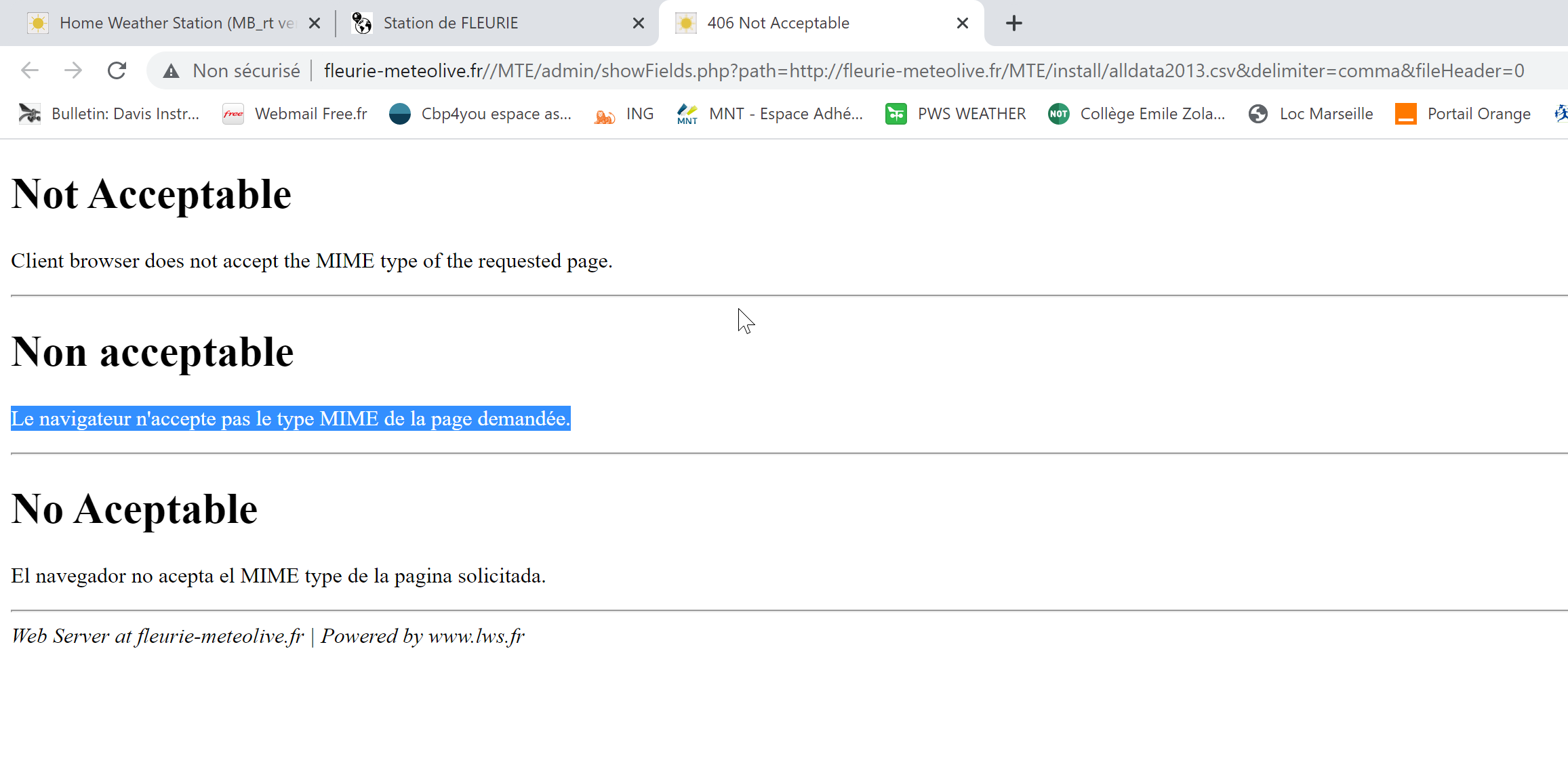

Following a problem with my host I lost the history of my database
As I had saved a data file in .CSV I wanted to reload it from the control panel mode in Data Import but it gives me an error code:
E 406 The browser does not accept the MIME type of the requested page.
do you have any idea how to load the data
Thanks in advance
erreur E 406.png (140.35 KiB) Viewed 33857 times

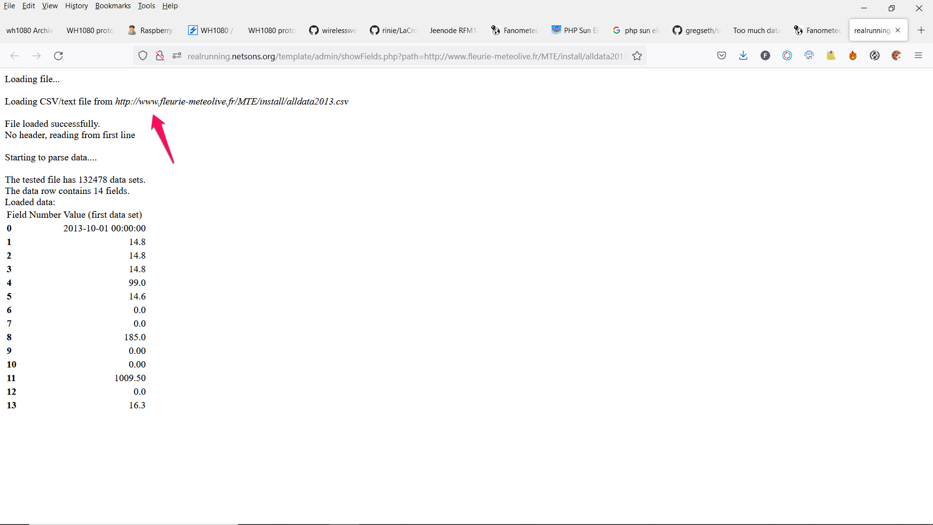

Re: Too much data in the DB ?
Posted: Thu Aug 05, 2021 2:12 pm
by davidefa
I've tried your setup and works for me ( with firefox )
( both with and without leading 'www.' )
I've searched about error 406 and found that even if the error is 'client side' generated the source may be more difficult to pinpoint ( should be some 'incomprehension' between server and browser ).
I suggest the following:
- try using a different browser; even starting the browser in 'clean mode' ( without extension enabled ) may be worth trying
- try using a different computer/operating system
( if you don't have access to a different computer you may download a virtualizing software such as vmware, a virtual machine with linux already installed and repeat the import from within the virtual ambient )
Posted: Thu Aug 05, 2021 5:25 pm
by PNCATTE
Thanks for this information, I tried with three other browsers and a MAC ditto
I can't find my problem if I launch the link:
http://fleurie-meteolive.fr/MTE/install/alldata2013.csv
I see downloading the data file
Can you try by accessing my site with the password: 12345 to see if it is not from a corrupted file on my server?
http://fleurie-meteolive.fr/MTE/indexDesktop.php
Thank you for your help
Pascal
Posted: Thu Aug 05, 2021 7:03 pm
by davidefa
The 12345 password does not work for me
