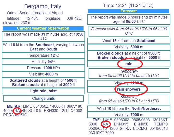

Post by meteoesine » Sun Nov 05, 2017 11:57 am
Hi to all,
I'm coming back again with this topic as I would like to point out once more I think there is something does not is well running between interactive banner and metar/taf report.
I noted these inaccuracies only after the upgrade to version 15 black currant.
As you see in the attachments it's raining but the interactive banner shows blue sky...
I'm not very skilled neither about metar/taf nor about MeteoTemplate technicalities, all I did was cancel out the caches as suggested without success, but it's clear there's something wrong somewhere.
thanks
Norbert
Re: Header background doesn't always match METAR report
Post by Jachym » Sun Nov 05, 2017 1:03 pm
Yes, but you must not forget this is cached, it must be, it is on every page and if it was updating the METAR with every page load it would slow down the page a lot.
