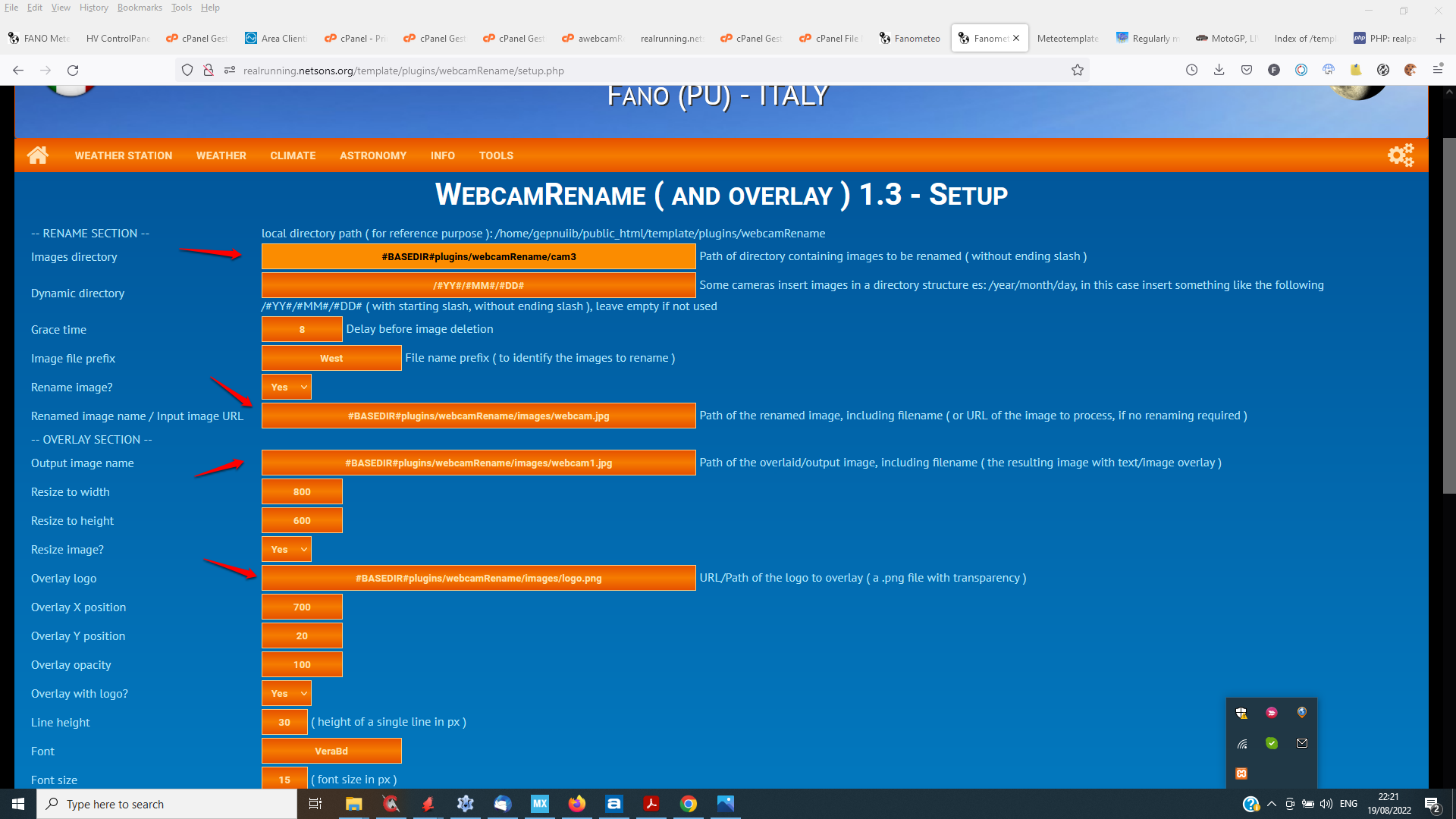

- added #BASEDIR# constant ( to use as relative path 'base directory', which represents the meteotemplate base directory, generally called template )
#tobydude
You can install this version of the plugin, and run the setup, setting the following fields:
Images directory
#BASEDIR#plugins/webcamRename/cam3
Renamed image name
#BASEDIR#plugins/webcamRename/images/webcam.jpg
Output image name
#BASEDIR#plugins/webcamRename/images/webcam1.jpg
Overlay logo
#BASEDIR#plugins/webcamRename/images/logo.png

Strangest thing. The #BASEDIR# did not work for me so I tried "/home/fjrvofei/public_html/template/plugins ******" again and now the image is showing. I put the webcam in the middle of the page, to the right.
The webcam plugin is not there yet. But the webcam is up and thats what I wanted.
Thanks for helping.
The setup is now like this now:
