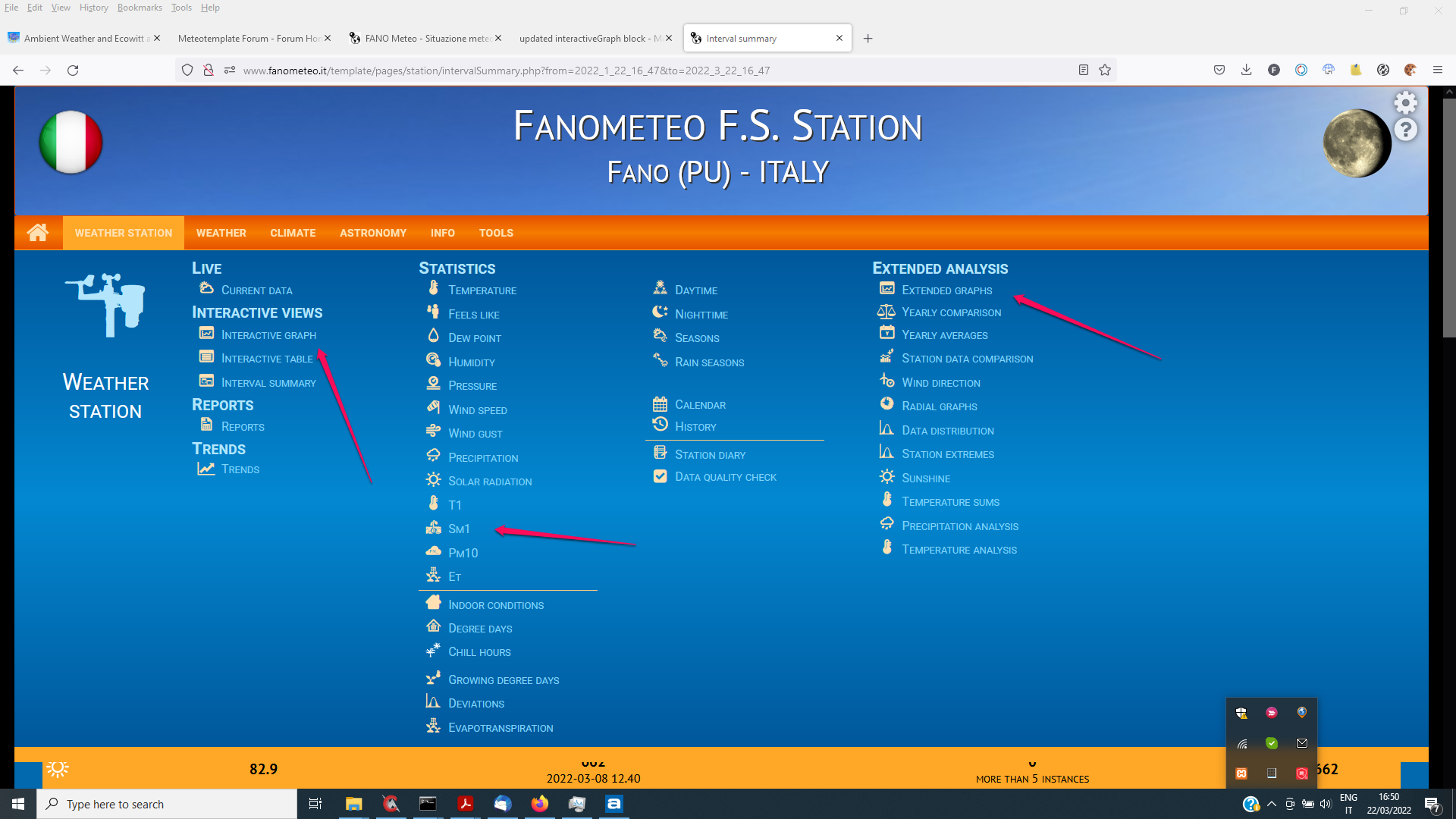

Posted: Tue Mar 22, 2022 2:47 pm
by Gerrit
Good day to you,
what a nice adjustments these are, especially the possibility to show graphs of the soil sensors, that was the only thing that kept me with another software package, which I will stop right now.
I do have a small problem, which is also with the original file, that during the loading the program temporarily freezes.
Furthermore, I have the question if there are also adjustments possible to view the history of the ground sensors, I have data from 2018 onwards.
Gerrit
Re: updated interactiveGraph block
Posted: Tue Mar 22, 2022 4:18 pm
by davidefa
I'm currently working on extending The interactive and the extended graphs.
I've already updated the 'statistics' pages ( but currently didn't post the mod )
Please post a link to your site so I can take a look at the 'freezing issue'
