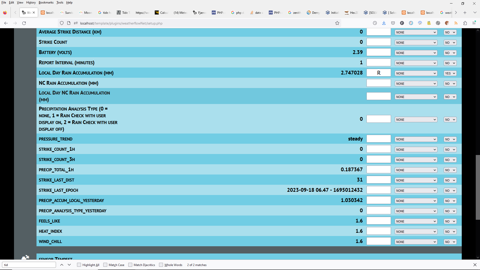

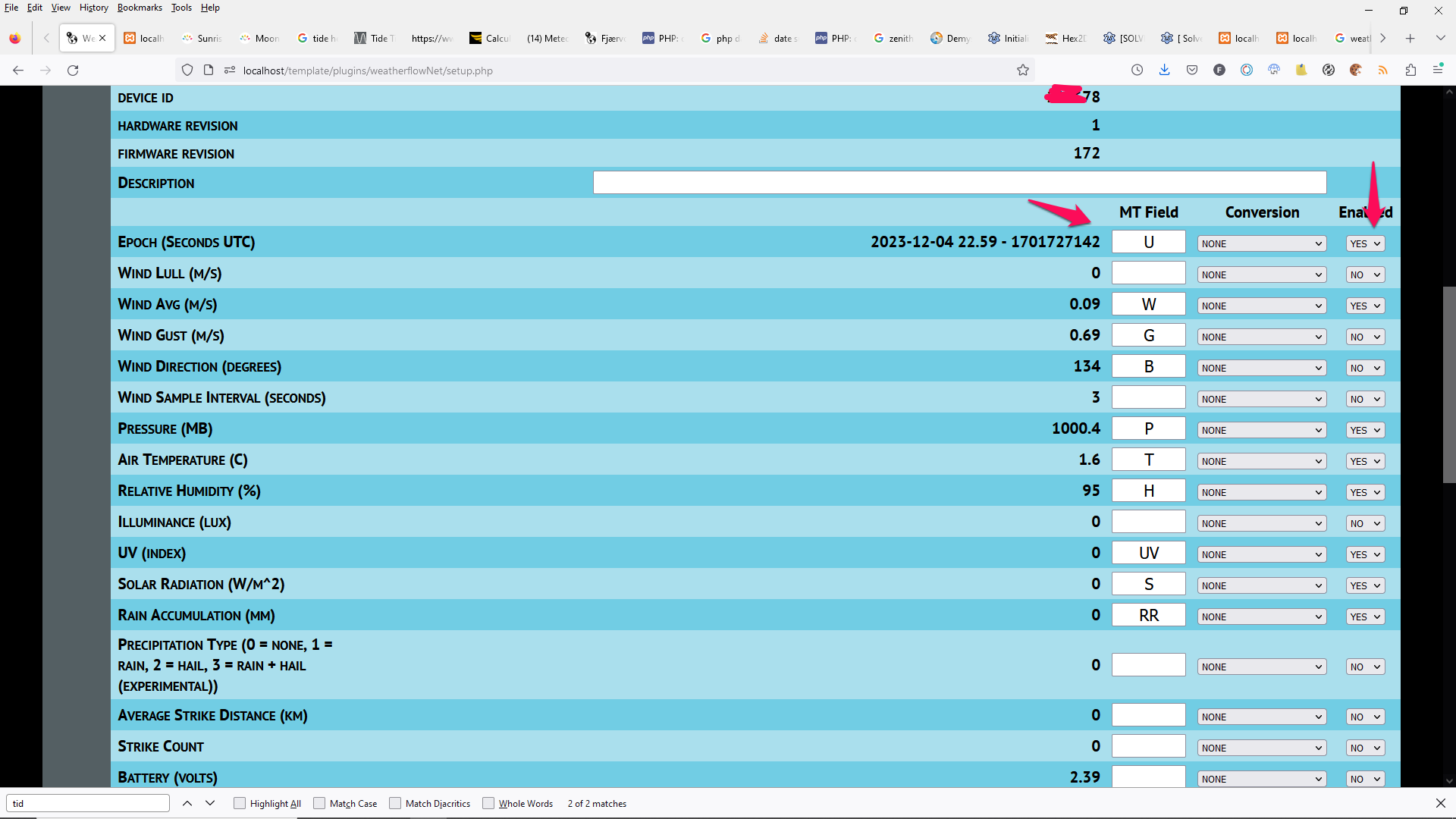

Regarding the weterflowNet plugin you have to rerun the setup:
- enable only the sensors you need
- for each sensor enabled you have to define a name in the column MT-field
This should be a starting point:
NOTE
Not sure about the R and RR fields as the weatherflow documentation does not clarify the meaning of the rain fields.
In the old weatherflow plugin, the old field nomenclature was:
precip_accum_local_day -> R
precip_accum_last_1hr -> RR

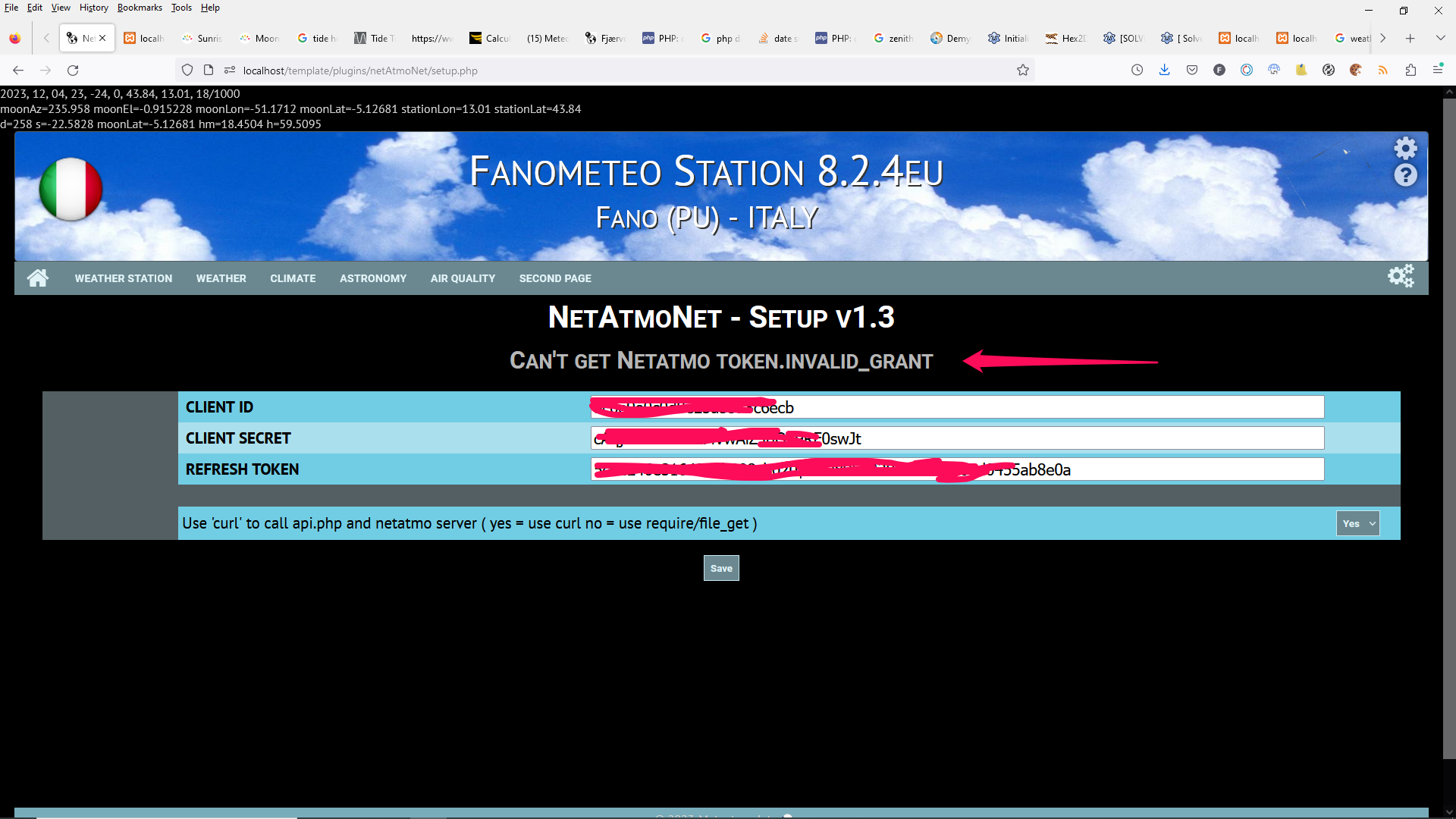

davidefa wrote: Mon Dec 04, 2023 10:40 pm So double check the plugin setup if the inserted credentials are still valid ( for example, if you have removed/deleted the previous configuration file... )
There's something wrong with the way the netatmo creds are given/obtained. It works for a few hours, then breaks, and the token goes back to being expired:
netAtmoNet
No password provided
Notice: Undefined variable: password in /var/www/client2/web2/web/plugins/netAtmoNet/updateNetAtmoNet.php on line 41
Notice: Undefined variable: password in /var/www/client2/web2/web/plugins/netAtmoNet/updateNetAtmoNet.php on line 43
This is not how it should be done, I fear. Or I should change permissions of the plugin files, or some external party is messing with it, but to what do I change the permissions of those files?

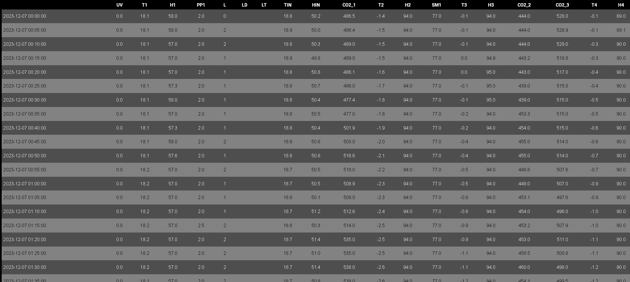

Another strange issue arised; There are no minimum and maximum values being shown for the netatmo and weatherflow plugin in the stationdata block, see here.
The internal values from meteobridge do just fine, all the others do not. Why can that be?
The apilog.txt shows no errors though, mysql is not showing errors either (I already fixed/repaired tables etc.).
It would be nice to have a root shell-script that just sets all permissions correctly, like I have for wordpress sites, but then for the meteotemplate web-root.
As you can see, the customGraph is also not updating (because there's no history for those sensors?), plus, it isn't showing values under zero Celsius.
Strangely though, the values are all recorded just fine:
Screenshot 2023-12-07 at 20-38-19 Broekermeer Weer.png (91.97 KiB) Viewed 31868 times
Why are min and max not showing?
