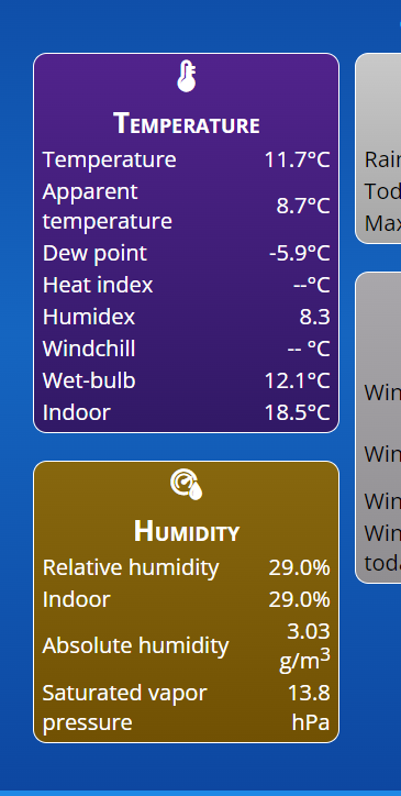

A question about the wet bulb reading in the current conditions block (detail view):
the wet bulb temp seems to be always above the actual outside tempearture.
I think that's not correct ;) , it should be way less.
Also the windchill tempearture isn't always showing: maybe it's calculated only every 10 minutes????
the heatindex is never showing.
I transfer data through my meteobridge coming from my weatherlink live davis station, maybe the settings there aren't correct?

when I do this with my current conditions I find 2.4C
When I do the artan formula I find 4.4C
My weatherlink says : 1.7C
I edited my updater.php to the arctan formula, already much better.
But I don't know how to php the above more correct formula.

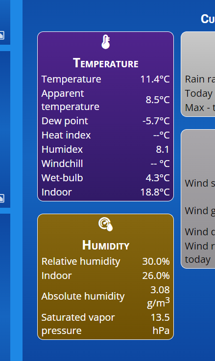

PS: wet bulb can never be above the outside temp otherwise we humans could not cool ourselves.
ok for the heatindex and the windchill, although I would like to see it always
I attached some screenshots before adjust updater, and after , and a aplication note from davis instruments about their calculated measurements.
