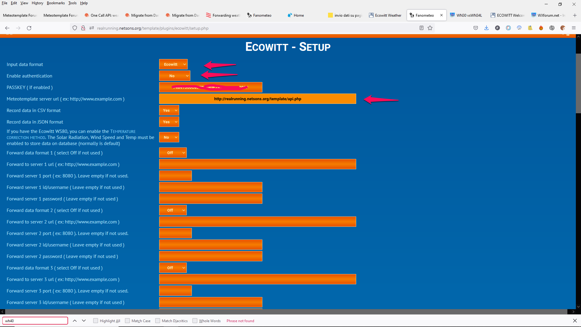

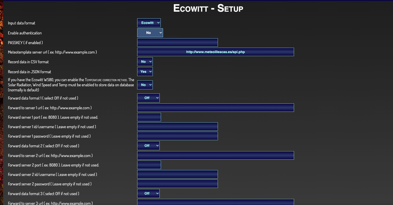

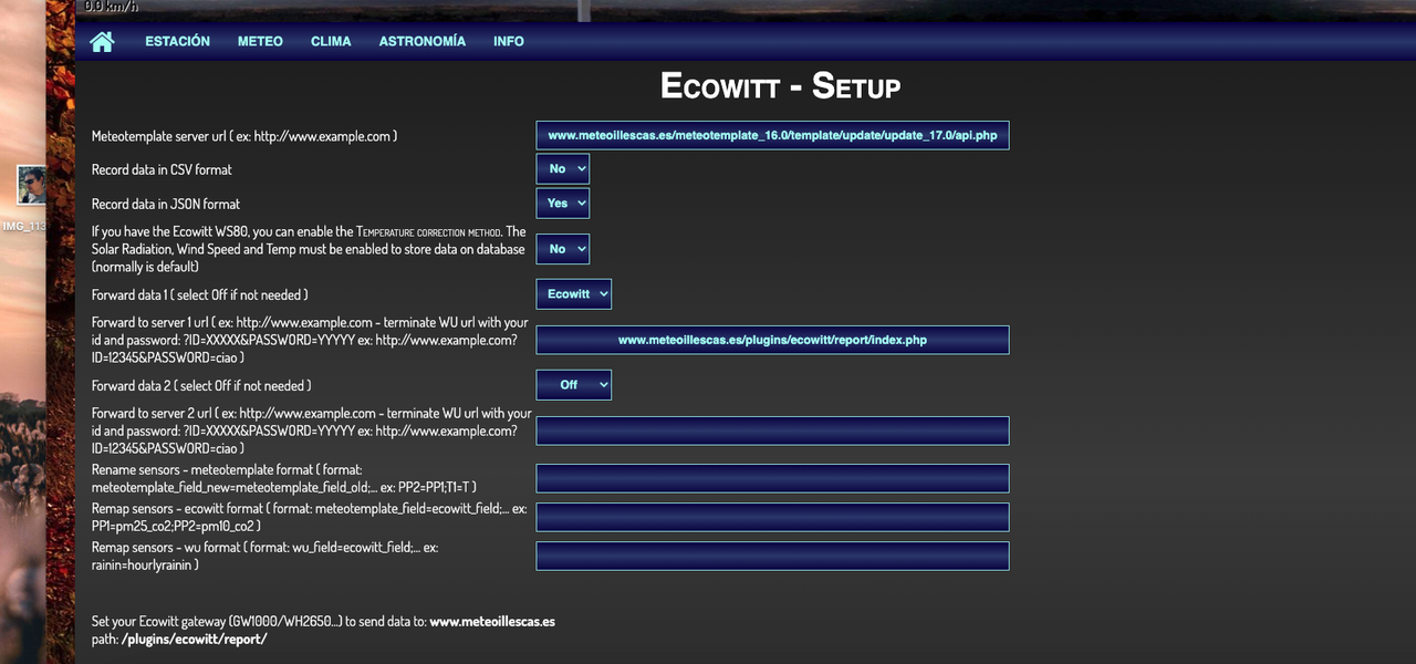

this is what i have so far
Re: Ecowitt
Post by davidefa » Mon Oct 25, 2021 2:07 pm
For a basic setup you need to set the following 3 parameters ( in Meteotemplate server url set http://www.meteoillescas.es/api.php )
Set Forward Data1 to Off

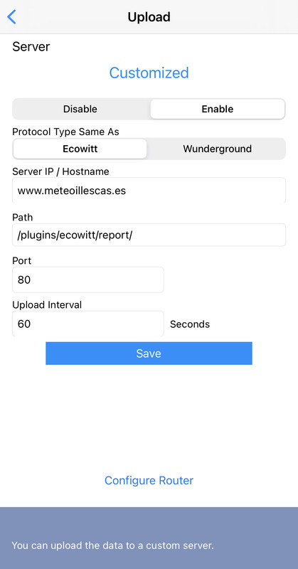

In WsView app set your 'custom upload' to:
Server IP/Hostname: www.meteoillescas.es
Path: /plugins/ecowitt/report/
( if you are using a different software upload to www.meteoillescas.es/plugins/ecowitt/report )

Post by Oscarmr » Mon Oct 25, 2021 4:50 pm
Thanks. It is correct now ?
Re: Ecowitt
Post by davidefa » Mon Oct 25, 2021 9:10 pm
Yes, it is.

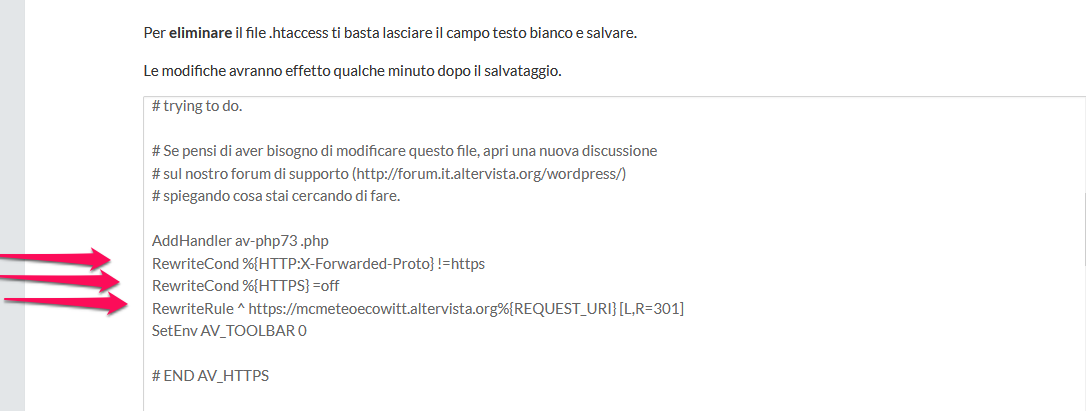

This is due ( in my opinion ) to the automatic http to https redirect of your site.
( other users of the italian provider altervista.org are experiencing the same problem )
The only workaround I found was to disable the automatic redirect ( in their case editing the file .htaccess ).

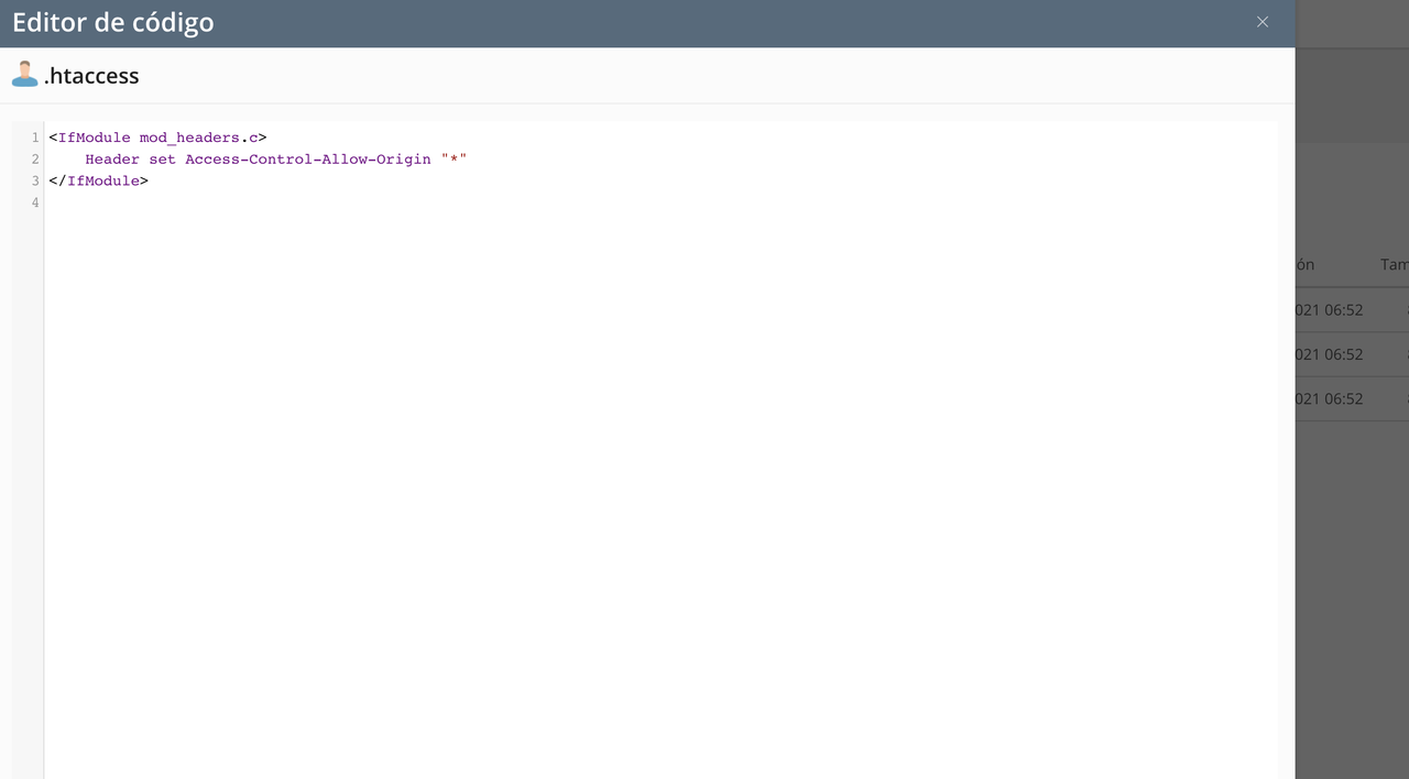

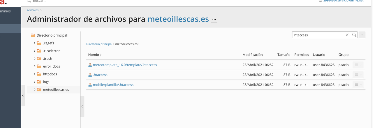

Excuse me again. This is the file that I should edit? I don't really know what to change . Thanks !

Post by davidefa » Mon Oct 25, 2021 10:27 pm
On the italian altervista.org the only way I found was to comment the 3 lines in the attached image.
But this is not your case.

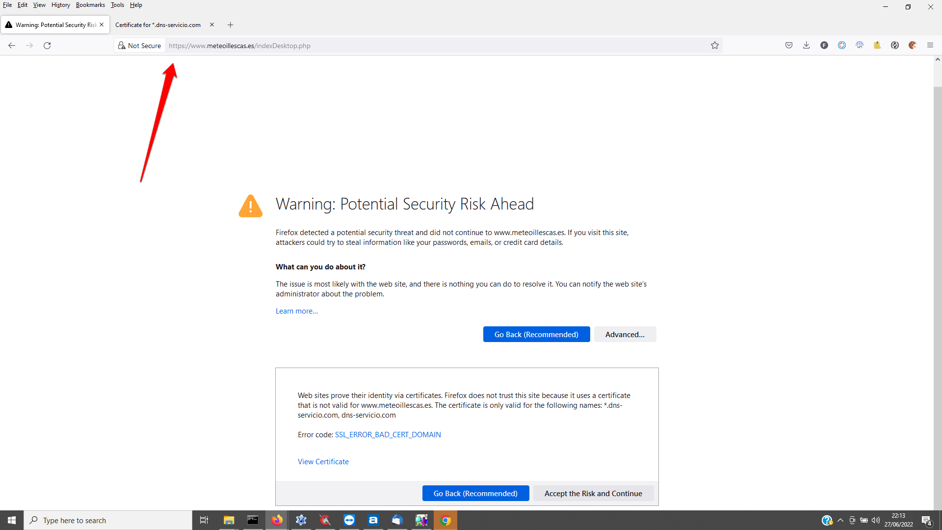

I have disabled the SSL certificate so that my website does not redirect to https, but to http. but it still doesn't work. Is what I did correct?
Re: Ecowitt
Post by davidefa » Mon Jun 27, 2022 8:30 pm
It seems that http to https redirect is still active ( if I write http://www.meteoillescas.es/indexDesktop.php I'm redirected to https://www.meteoillescas.es/indexDesktop.php ), but now firefox complains about security risk.
I see your server is an nginx ( which uses a different configuration file, look in the 'control panel' of your hosting provider if there is something related to the server configuration )

davidefa wrote: Mon Jun 27, 2022 8:30 pm It seems that http to https redirect is still active ( if I write http://www.meteoillescas.es/indexDesktop.php I'm redirected to https://www.meteoillescas.es/indexDesktop.php ), but now firefox complains about security risk.
https://www.google.com/search?client=fi ... s+redirect
Contact my hosting support and according to their response my redirection to https is disabled. It seems to me that it will be an impossible task to get it to work, at least in my current hosting.

Post by davidefa » Tue Jun 28, 2022 8:49 pm

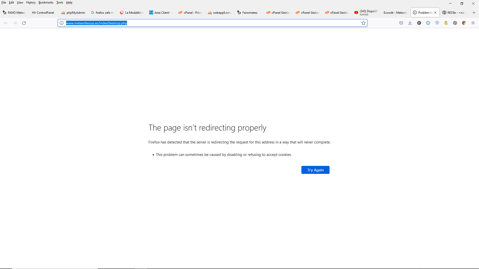

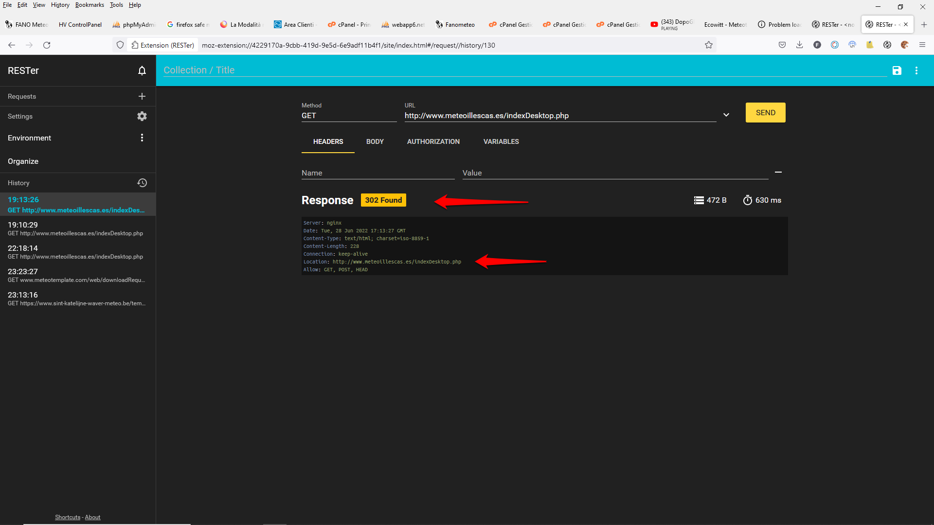

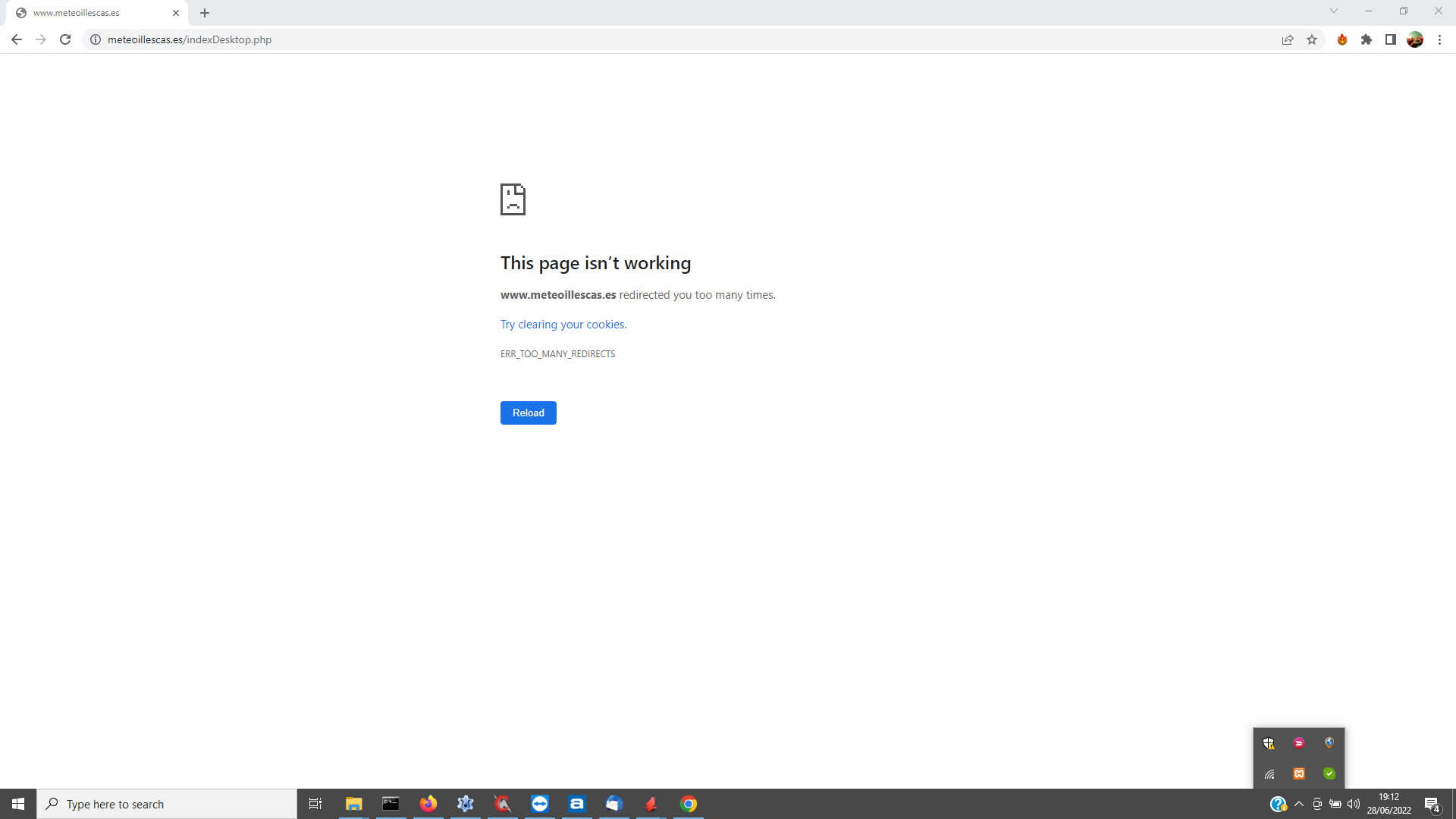

Not sure they did a good job.
Both firefox and chrome report that redirection never completes ( when pointing the browser to http://www.meteoillescas.es/indexDesktop.php ).
The 'rester' addon of firefox shows the reason: http://www.meteoillescas.es/indexDesktop.php is redirected to http://www.meteoillescas.es/indexDesktop.php ( in a never ending loop )
