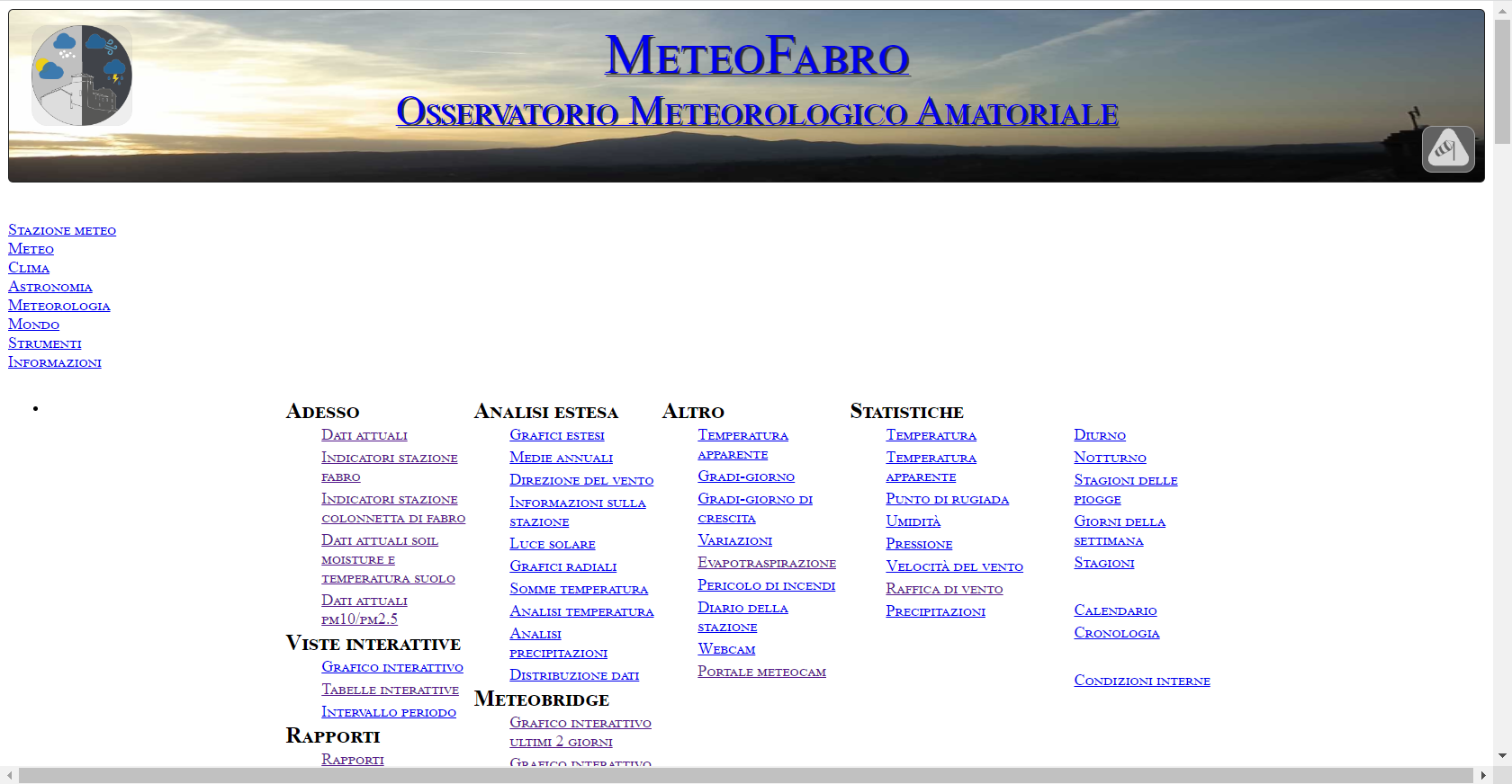

I have a problem with my site after activating the HTTPS protocol on ALTERVISTA.ORG.
If I launch an unprotected HTTP the pages work wonders, if by chance the same pages are loaded with secure HTTPS, the pages are loaded partially as per the attached image.
Has anyone already addressed the problem?
HTTPS protocol on ALTERVISTA and display problems

Re: HTTPS protocol on ALTERVISTA and display problems
I am trying to redirect the HTTP to HTTPS pages of the domain to .htaccess.
What instructions should I write since I have a main domain (http://meteofabro.it) and an Altervista sub domain (http://meteofabro.altervista.org)?.
Thanks David.
The code to add in the .htaccess file works.
But I have another problem, some external links that I was on some blocks and plugins don't work.
I have solved many of them by putting the link in "https://", but unfortunately other portals have not set up the server in the secure http protocol, so I still have to use "http://" to call the link.
Here are some links of the Plugins that don't work:
1) https://meteofabro.altervista.org//plug ... nnetta.php
2) https://meteofabro.altervista.org/plugi ... /index.php
3) https://meteofabro.altervista.org/plugi ... /usNWS.php
4) https://meteofabro.altervista.org/plugi ... /index.php
Can I fix it by putting some code on .htaccess?
Not in .htaccess, but you can do it in your browser.
Your browser is set to disable 'mixed content' loading ( this is a security settings ):
if you disable it you are allowed to load 'https pages' that contain http resources/images ( it is a good idea to disable it only for selected sites ).
As this is a browser setting, visitors will load your pages correctly only with 'mixed content' settings disabled
Only these settings will work.
the others need an update anyway
