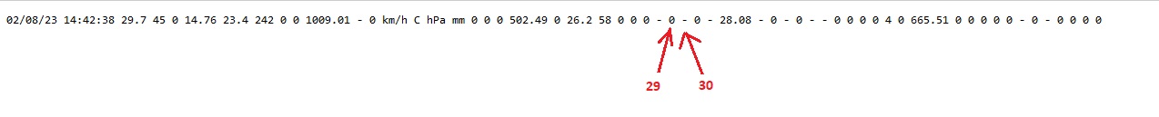

I've been using the Ecowitt plugin (by raffaello Di Martino) for some time, updated by @davidefa (my current version is v3.2) and it works great but, analyzing the realtime.txt file (CumulusMX format), generated by activating the option in the settings, I noticed that not all data are loaded / updated but "0" or "-" is indicated.
For example, in my case I would need the values of today's minimum temperature with the time, from the official Cumulus page https://www.cumuluswiki.org/a/Realtime.txt these are fields n° 29 (<#tempTL>) and n° 30 (<#TtempTL>) if I am not mistaken and I understood correctly; in the generated realtime.txt file those fields show the values as in the picture:
Can anyone tell me what this is due to?

Post by davidefa » Sun Oct 08, 2023 4:30 pm
Update the ecowitt plugin to latest version ( 3.4, see this post )

davidefa wrote: Sun Oct 08, 2023 4:30 pm Update the ecowitt plugin to latest version ( 3.4, see this post )
Hi, thank you very much and welcome back!
