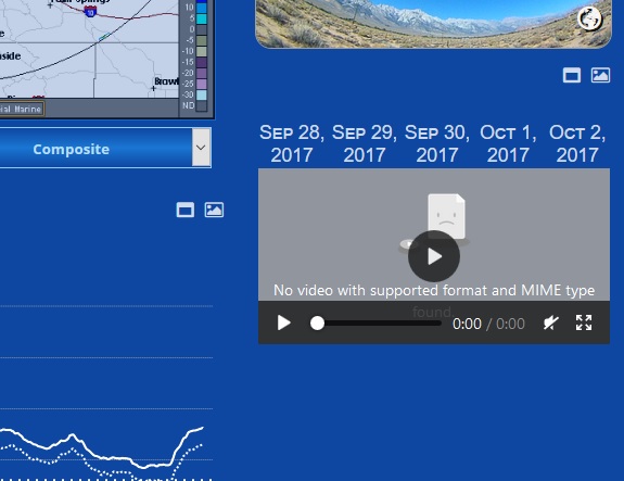

So, I have traced it down to running the site via https. As of now, it's showing a strange error (Shown below).
I have tracked it down to the bsCache.txt file. The URL's to AWS is http. When I replace all to https, it works great. I checked bloomskyTimelapseBlock.php and changed all http to https. It breaks the block.
Does anyone know of a way to modify the code so when it updates the text file, it uses https?

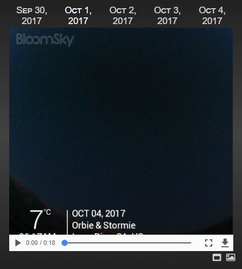

Hi Christopher, just to let you know that your Bloomsky video is visible right now, I'm guessing you've gone back to HTTP mode. I think this is going to be one of those questions for Jachym to answer.
Orbie and Stormie Bloomsky.JPG (29.19 KiB) Viewed 24563 times
