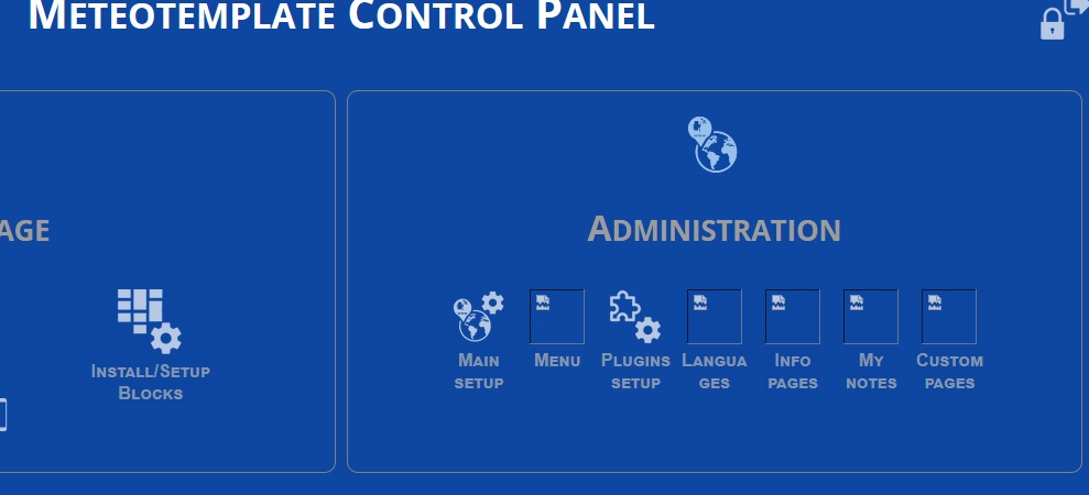

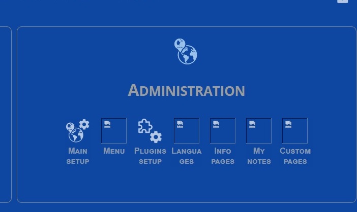

I have been noticing that several icons are not showing up on my page. I am missing the icon above the gear icon on the right hand side. It's the High temperature warning. Also on my control panel page, several icons are missing scattered throughout.

Fraggboy wrote: Thu Sep 28, 2017 8:48 pm I have been noticing that several icons are not showing up on my page. I am missing the icon above the gear icon on the right hand side. It's the High temperature warning. Also on my control panel page, several icons are missing scattered throughout.
Now these questions I can't help you with. I see what you mean about the warning symbol on the right hand side, there is a tiny little graphic there - not sure what that is. As for your control panel, use your snipping tool and post an image of the panel so Jachym can see it - he might know what the problem is and will hopefully suggest a fix.

Post by Fraggboy » Thu Sep 28, 2017 10:15 pm
I have attached the different areas that the icons aren't showing up.

Re: How to show Bloomsky data from weather station?
Post by Jachym » Fri Sep 29, 2017 1:10 pm
Most likely you uploaded all the files directly in your server root and are using Linux server. This will not work, it is explained in the wiki too:
http://www.meteotemplate.com/web/wiki/wiki3GB.php -> NOTE FOR LINUX APACHE SERVERS
You need to place the files in a subfolder.
Post by Fraggboy » Fri Sep 29, 2017 2:28 pm
Jachym,
Thank you sir! That did fix it. Now, I ran into another 'issue' since I overlooked that crucial step. You have to get into the main setup and change the page URL and add /template. Save and it's all good. :)

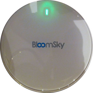

How do you know your Storm goes out of sync? Does the little WiFi receiver LED change colour or no data showing on the app?

I don't look at the storm dongle as much. I notice that when any of my app fields (Wind, Gust) goes -- that means it lost it's connection. I believe that the dongle LED flashes red. Since we can't power-cycle the storm, the only fix I know of is to remove it from the app, plug the storm into the dongle, and re-add it..

Ah, that's a pain to have to do, I have occasionally noticed the LED turn red, but then it reverts back to green within a minute - but its rare that I see this.
I can only guess it's lost it's connection to the little WiFi dongle box, the only way to check that would be to temporarily extend the dongle's cables closer to Storm to see if that helps.

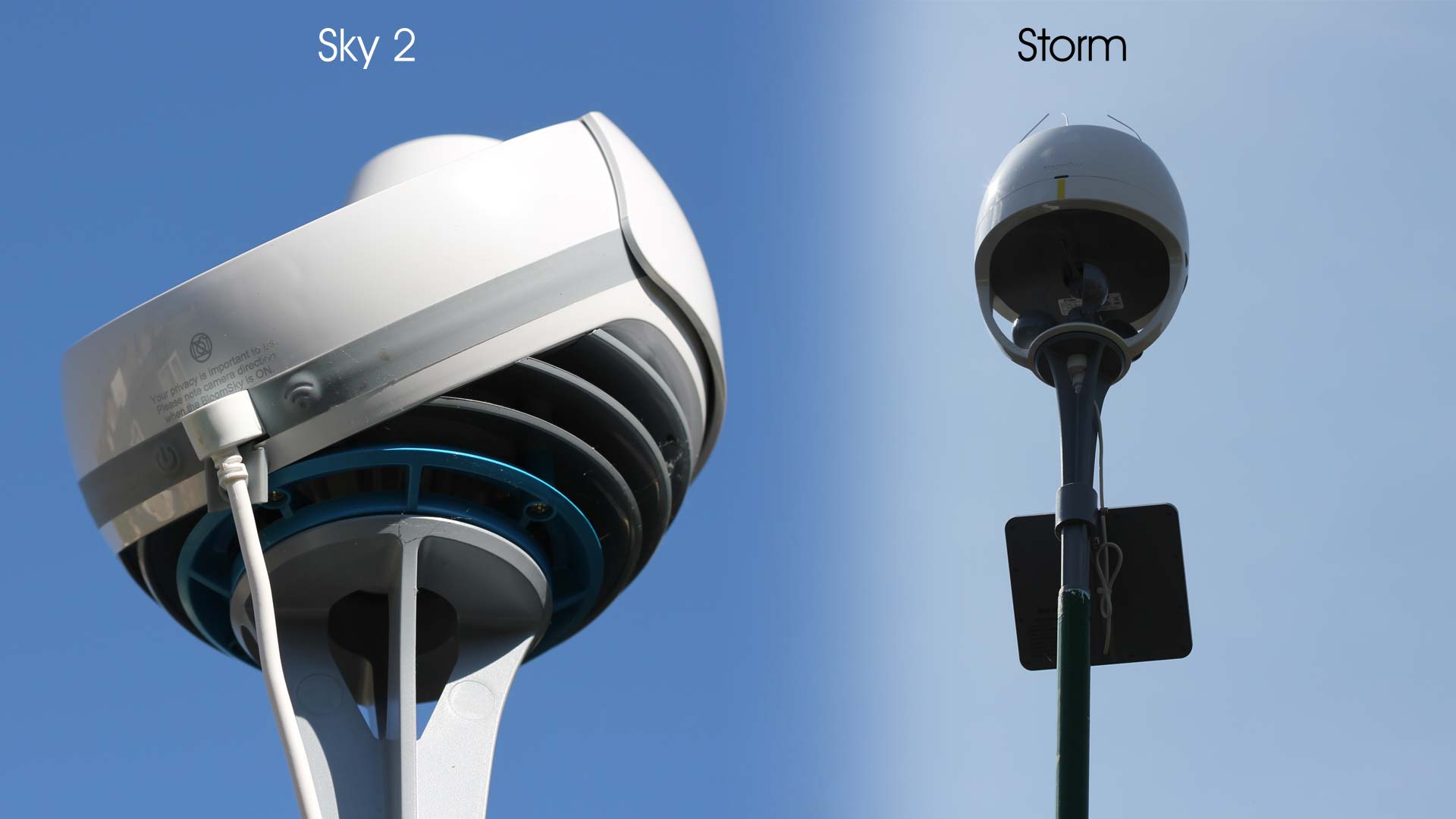

The hole on the side of your storm looks pretty nasty. When's the last time you have taken it apart and cleaned it? I've been doing mine once a month.
Post by Johnny » Sun Oct 22, 2017 3:44 pm
Hi Christopher, I've only just seen this post, I'm guessing you're talking about the little yellow mark you can see on the Storm face image above. It's actually a piece of yellow Dymo like tape, I put this on to assist me in making sure that the unit faces north. It's close to 6 metres high and very hard to align it unless there's a visible mark for guidance.
