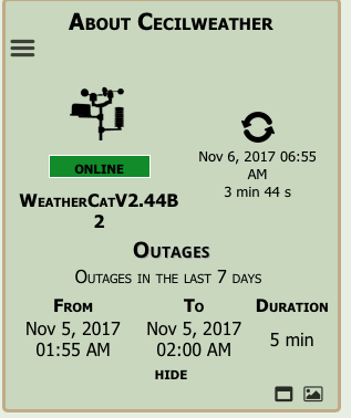

Post by MonyMony » Mon Nov 06, 2017 12:08 pm
Noticed that the info block is reporting my station was offline but actually this is when Daylight Saving Time ended. Very minor issue and personally I don't need any action taken on this but just wanted to make the behavior known.
Screen Shot 2017-11-06 at 6.59.14 AM.png (33.73 KiB) Viewed 6064 times

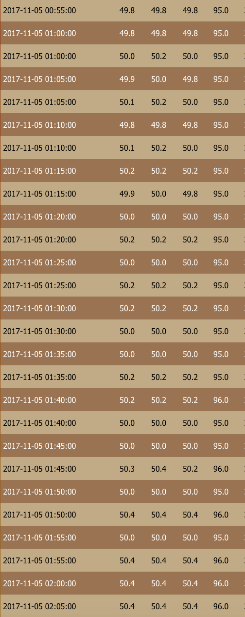

Screen Shot 2017-11-06 at 7.06.47 AM.png (110.9 KiB) Viewed 6064 times

I noticed that as well on both of my sites. There would have been duplicate data attempting to be written for a one hour period when the time changed back an hour.

This is unsolvable. I would have to stick with winter time in the template to get this right and people would complain because it would not really correspond to real time. Here at our institute we use UTC for this reason, but that also wouldnt be welcomed...
So what happens is that once per yr, one hour is missing in the db, and once per year one hour is overwritten (so in a sense also missing)

I will say storing data in the local time is much preferred versus UTC which can cause its own confusion (Now to I subtract four hours or five??). Interesting in my screenshot that the data is not actually overwritten as you mention as I end up with two entries for an hour. I am fine with this behavior and just wanted point out this quirk the end of Daylight Saving Time.
