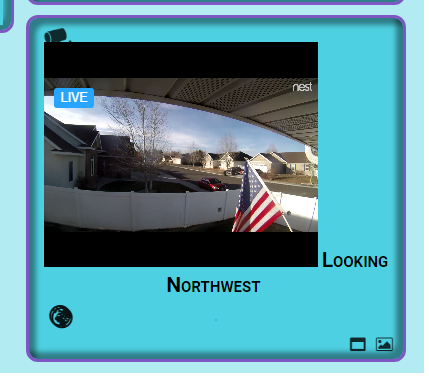

My web coding skills are very lacking using .php & CSS. I am hoping that someone can assist me with the webcam block.
I use a NEST camera which is hosted on their site so I have no control over URL etc. I can access this camera at https://video.nest.com/live/5lCxaI7Qi6, So I used that URL in block setup, but nothing loaded.
NEST also provided the following code to embed on the site.
<iframe type="text/html" frameborder="0" width="480" height="394" src="//video.nest.com/embedded/live/5lCxaI7Qi6?autoplay=1" allowfullscreen></iframe>
I placed this line in webcamBlock.php as such:

<iframe type="text/html" frameborder="0" width="274" height="225" src="//video.nest.com/embedded/live/5lCxaI7Qi6?autoplay=1" allowfullscreen></iframe>

I totally kludged this code. I'm not proud of it but it works, kind of. I changed the size of the image to fit on my page.
Obviously, this doesn't scale as everything else that Jachym has created. Is there a fix for my abomination without rewriting the block? I certainly don't expect anyone to do that. Is there a cut and paste solution?

the problem is in the iframe fixed dimensions. Change it for example like this:
<iframe type="text/html" frameborder="0" style="width:98%;margin:0 auto" src="//video.nest.com/embedded/live/5lCxaI7Qi6?autoplay=1" allowfullscreen></iframe><br>

Thank you, Jachym. That did the trick
