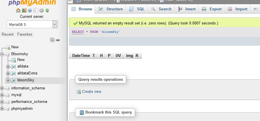

I need assistance.. My Bloomsky plugin is not working correctly. I had some inaccurate data I wanted to remove, and I needed to start over from scratch. I removed all of the databases/caches and everything seemed OK.. Except that when I check my page, and select a date, nothing is shown. There are no video files downloaded when the update pages are run as well as no images are stored under the template sub-folder. Images are being downloaded.
https://www.fraggboy.com/template/plugins/bloomSky/
I also noticed that the data is not being populated to the database. I have removed the bloomSky database, in which the php page creates it. It's just not writing to it.
I have bsAPI.php, update.php, and bsUpdate.php run every minute via CRON. When I run them manually, they are successfully running.
I double/triple checked the permissions on the folders, as well as the database. It's not permission-related since it can create the database and download the actual images. It's not converting them to the thumbnail size and adding them to the folder, as well as writing the data to the database..
Help please.

The only thing that works is when I remove the database and when the script runs, it creates the database/fields, as well as it does grab the json data. It's just not writing to the database, or creating the thumbnails. If it was a permission error, it wouldn't be able to create the database.

Updates are working as the data is being populated in the alldata database. It's not inserting the data into the bloomSky database. It's also not creating the thumbnails, and the videos aren't being downloaded.
