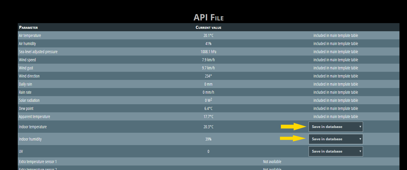

have you enabled the extra sensors data base?
Have you moved updateIndoor.php to the /load/crons/ folder?
Have you installed a cron job?
Not sure where you stand in the process, but all these things have to be done.

Post by Juan Maria Vilaro » Sun Apr 15, 2018 11:21 am
Thanks, you could tell me where and how the additional sensors are activated.
I do not know where to do it.
In Weather Display, I have the Meteotemplate CRON running to work with API.
The updateindoor.php file I have put in "Load / Crons / updateindoor.php"

Sorry, I have already been able to activate the extra sensors, but they still do not appear in the data.

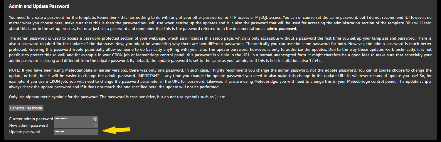

First you need to know your update password. You created it in the main setup.

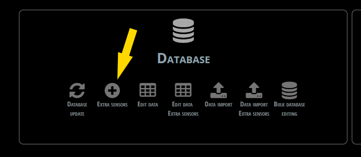

Next activate Extra sensors. From the Admin Control Panel:
then
Then move indoorUpdate.php to the folder ../load/crons/

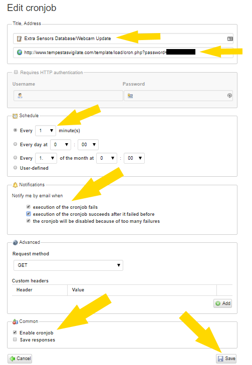

Re: INDOORDATA PLUGIN
Post by Dehatter » Wed Apr 18, 2018 12:14 am
goto www.cron-job.org
Create an account.
Then create a cron job.
it should look like this:
The blacked out area is where your update pw goes. Use your template path, not mine.
[*]http://www.yourwebsite.com/template/loa ... urUpdatePW
It should be working now.
