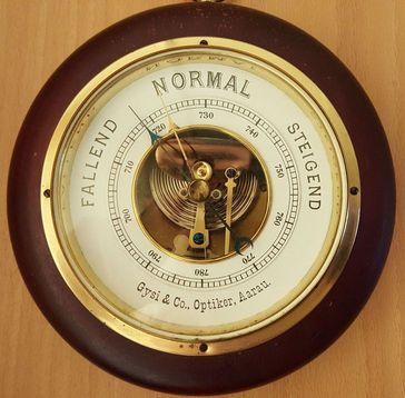

Since I got this
beautiful anaeroid barometer (showing air pressure at station level in mmHg) I dug a bit in the subject.
MT shows pressure values from the Meteostick, the Davis Console instead has its own pressure sensor and shows a slightly different value.
Both sensors of course measure the pressure at station level (QFE) and convert it with one of the numerous formulas in sea level pressure (QNH).
The precision of the sensor measures is 1 hPa (Console) and 0.1 hPa (Meteostick and my Galaxy S6 Edge).
Trying out different formulas to calculate the reduced air pressure at sea level showed little differences. Given the extreme variability of the air pressure QFE and the hazardous calculation of pressure QNH a precision of 1 mb seems good enough.
Davis support gave me a detailed information about how the Console is calculating QNH. Boris Pasternak (Meteostick) refused to answer the same question and instead accused me to argue with him about the best formula to use...
Anyone happens to know more about the Meteostick way to calculate QNH?

Really a tough one to answer since I see your MT reads as 999.2 and your analog as 718 or so. I am guessing you have some elevation to consider. If you are above sea level your analog will not take that into account. MH more than likely calculates your elevation and just guessing that is your 999.2 average. I know the formula but in inHg which will not help you.
If I knew your actual elevation I maybe could look it up for you.
