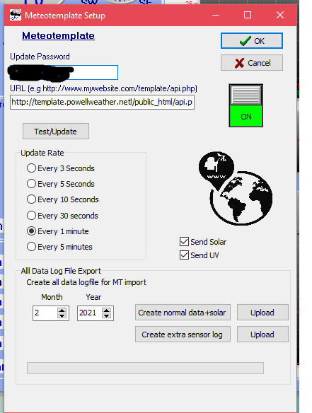

My weather page http://www.powellweather.net has quit updating the CurrentData and SSdials. In spite of everything I know to be true, I decided that it would be a simple fix, probably a password issue. Instead of developing a plan and proceeding systematically, I dove right in and starting making changes. Well if it's not the password it's probably . . .
I use Weather Display to send my data. WD is set up as: where /template is a subdomain of www.powellweather.net.
The file structure is root/www.powellweather.net/public_html/template
so
root/template.powellweather.net/public_html/ puts you in /template. This path operates without error in WD. This has been my setup until it stopped working.
My problem is I don't think that my current data is actually making it to /template on the host computer.
As I understand it, http://template.powellweather.net/public_html/api.php calls and

davidefa, I changed the URL.
Shouldn't meteotemplate.txt in /template root change each time the api.php script is run?
I don't know how to tell if the api.php script is being call and run. That would tell me if Weather Display is sending data.
