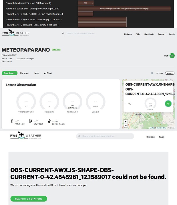

a few days ago I also updated the ecowitt plugin but I didn't realize that the Forward to server 2 towards https://www.pwsweather.com/pwsupdate/pwsupdate.php no longer sends data and I didn't understand why.
The only test I did was to change https and http but nothing.
Opening the php page gives this message "ERROR: Missing required parameter dateutc", while if I open the link of my station on the page https://www.pwsweather.com/station/pws/meteopaparano it indicates the PWS active but without data and clicking on the map icon it gives "OBS-CURRENT-AWXJS-SHAPE-OBS-CURRENT-0-42.4545981_12.1589017 could not be found."
What could it depend on?

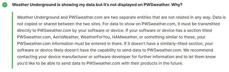

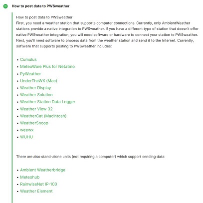

some possible solution to my problem to send data to http://www.pwsweather.com/pwsupdate/pwsupdate.php via the command forwarding to server 2 of the Ecowtt plugin?
I also tried to contact the support of PWSWeather to understand if it depended on them but, this was answered:
"PWSWeather and WeatherUnderground are not related in Any Way. As Such, We do not share or transfer any data with WeatherUnderground. You can find more information about this on our FAQ.
This Connection has to be done through Through Either Ambient Weather, or another of the support services or Third-party Software. Please refer to this list to determine Potential options for uploading your station's data to PWSweather."

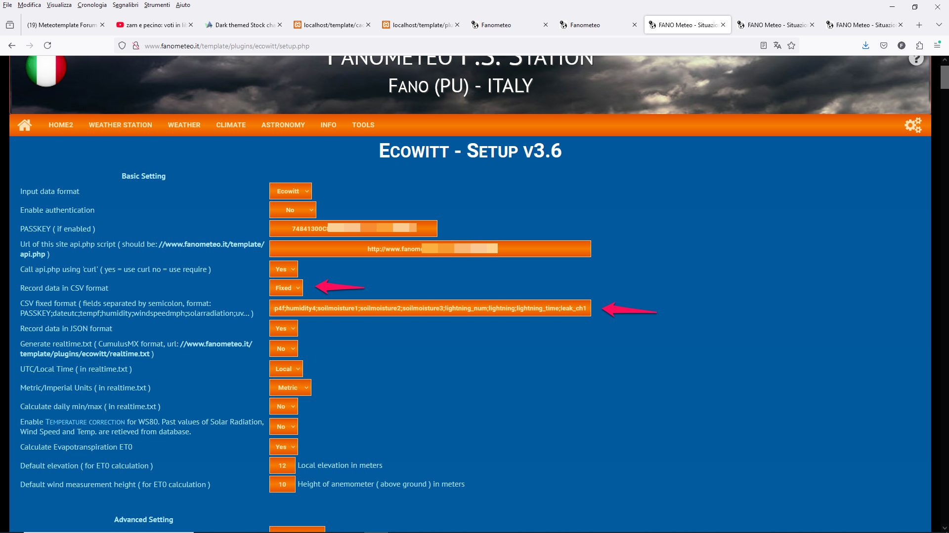

Posted: Thu Jan 02, 2025 5:43 pm
by davidefa
Minor updates to the plugin, for those who use the csv log files.
The format of the csv file may vary due to remote sensors not being received ( due to low batteries, interferences or bad weather for example ).
I've added an option to always save csv data in 'fixed' format, in this case you have to supply the list of sensors to save ( using the ecowitt field definition )
ver 3.6 2025/01/02
- the 'Record data in CSV format' has a new 'fixed' option
- added the 'CSV fixed format' option to specify the fields to save in the csv file
- added a maximum of 10 forwarders
