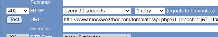

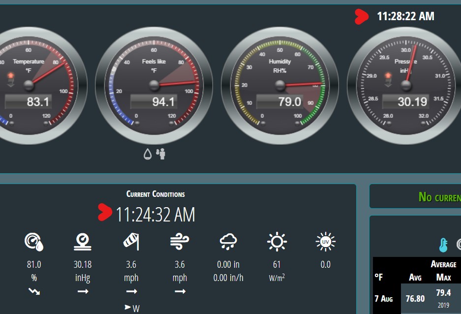

I am having issues with current block 24.3 (maybe).
PHP 8.0 and 8.1 will not update when the template is in 'Administration' mode (password entered). PHP 7.4 works fine.
If I refresh the page, it will display the current API setting, but will not update based on the time entered in settings.
ssGauges continues to update and works fine (your version).
After you click logout, it seems to auto update. If this intended, then so be it, but the block updates on PHP 7.4 no matter the mode.
Screenshot 2022-08-10 112912.jpg (95.9 KiB) Viewed 59859 times
Also, and maybe it is just mine, but Meteobridge does not seem to deliver a consistent API update. I have it set for 30 secs, but sometimes it will not update for several minutes. I am running the Ecowitt setup with a service sending data directly to api.php with the Meteobridge info.
Screenshot 2022-08-10 114900.jpg (31.52 KiB) Viewed 59857 times

It should/could be a 'side effect' of the lightningew block ( as both blocks have a function with same name ). Try updating with this.
Re: Block Current
Posted: Wed Aug 10, 2022 6:07 pm
by Dehatter
Yes, the block is updating now. It even seems way more consistent.
Thank you again.

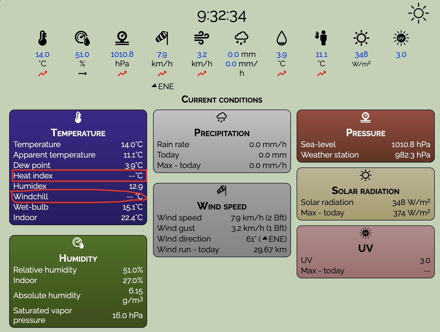

Can anyone help me...why is the heat index and wind chill not showing any values...is it something i can fix ?
Leon.

by davidefa
Wind chill is calculated only for T<=10°C and W>4.8km/h ( using this formula: https://en.wikipedia.org/wiki/Wind_chill )
Heat index is calculated only for T>=26.7°C ( using this formula: https://en.wikipedia.org/wiki/Heat_index )

by leonrossouw
Thank you ! :D

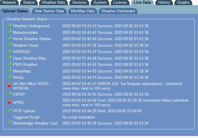

Ok I've pinned down one of my problems. It lies somewhere in the API.oho, Ecowitt plugin or the ecowitt block. Not sure which or where to look for the error. The apiview keeps changing from meteobridge and back to the ecowitt.net plugins it seems. It also changes time back a few min and stars over.If someone can look and see where this is it would be most helpful.
Which api.php ver, ecowitt block ver and ecowitt plug ver should I bee on to revieve date in meterbrdge only. I know I need one or other to revive lightningew to update correctly but going back and forth I seemed to trash the the thing.
Two or 3 of the blocks and plugins are bumping heads and I cant trace with is causing the errors. Sending to APRS don't function correctly.
Aprs 2022-09-02 041205.png (53.25 KiB) Viewed 59734 times
