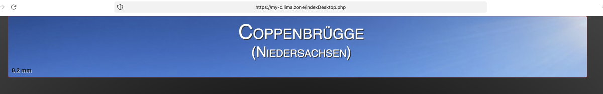

Post by Oli » Sun Aug 13, 2023 7:31 am
Thanks, I'll try not using my main provider.
Under php 8.1 I see so far only the header of the homepage (the logo with the name of my place and the values in the bottom left and the dynamic background set by the current weather).

Re: Meteotemplate - process of updating
Post by Jachym » Mon Aug 14, 2023 12:10 pm
Oli wrote: Sun Aug 13, 2023 7:31 am Thanks, I'll try not using my main provider.
Can you please send me a link to your test environment? You can email it to me if you do not want to post it here publicly.

i can confirm a privious post : only the banner is shown after update :-(

It is something with language, when you set "us" as lang in config.php, then it is working.
micjon
Posts: 3
Joined: Wed Aug 03, 2022 5:28 am
Station model: GW2000, Garni2055
Software: FOSHKplugin
Post by micjon » Mon Aug 14, 2023 5:47 pm
Error in log:
[php:error] [pid 8481] [client :42498] PHP Fatal error: Uncaught TypeError: array_key_exists(): Argument #2 ($array) must be of type array, null given in /var/www/html/meteotemplate/scripts/functions.php:114\nStack trace:\n#0 /var/www/html/meteotemplate/menu.php(482): lang()\n#1 /var/www/html/meteotemplate/indexDesktop.php(374): include('...')\n#2 {main}\n thrown in /var/www/html/meteotemplate/scripts/functions.php on line 114,
Post by Jachym » Tue Aug 15, 2023 7:39 am
Hi all,
please try replacing the scripts/functions.php with an updated version, I think I know what the problem is.

micjon
Posts: 3
Post by micjon » Tue Aug 15, 2023 8:01 am
yes, it is working again

Oli
Posts: 23
Joined: Sat May 28, 2022 4:17 pm
Location: Hamelin / Germany
Station model: HP1000SE PRO
Software: weeWX
Post by Oli » Tue Aug 15, 2023 2:38 pm
Jachym wrote: Tue Aug 15, 2023 7:39 am please try replacing the scripts/functions.php with an updated version, I think I know what the problem is.
I can confirm that it now works for me too.
edit: run it on my mainpage now and everything seems to run fine, at first under php 7.4 and now I switched to php 8.2.8 8-)
