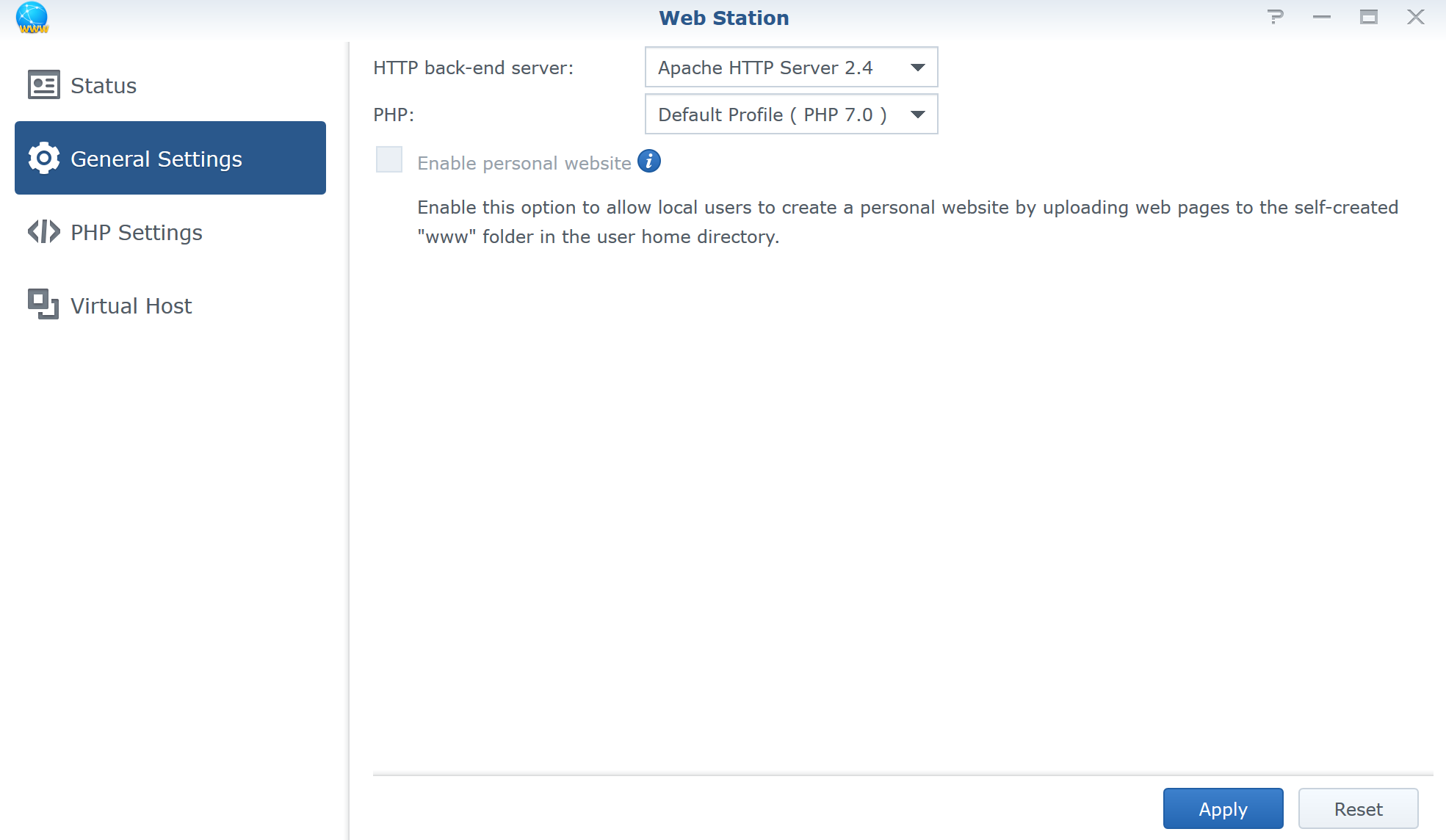

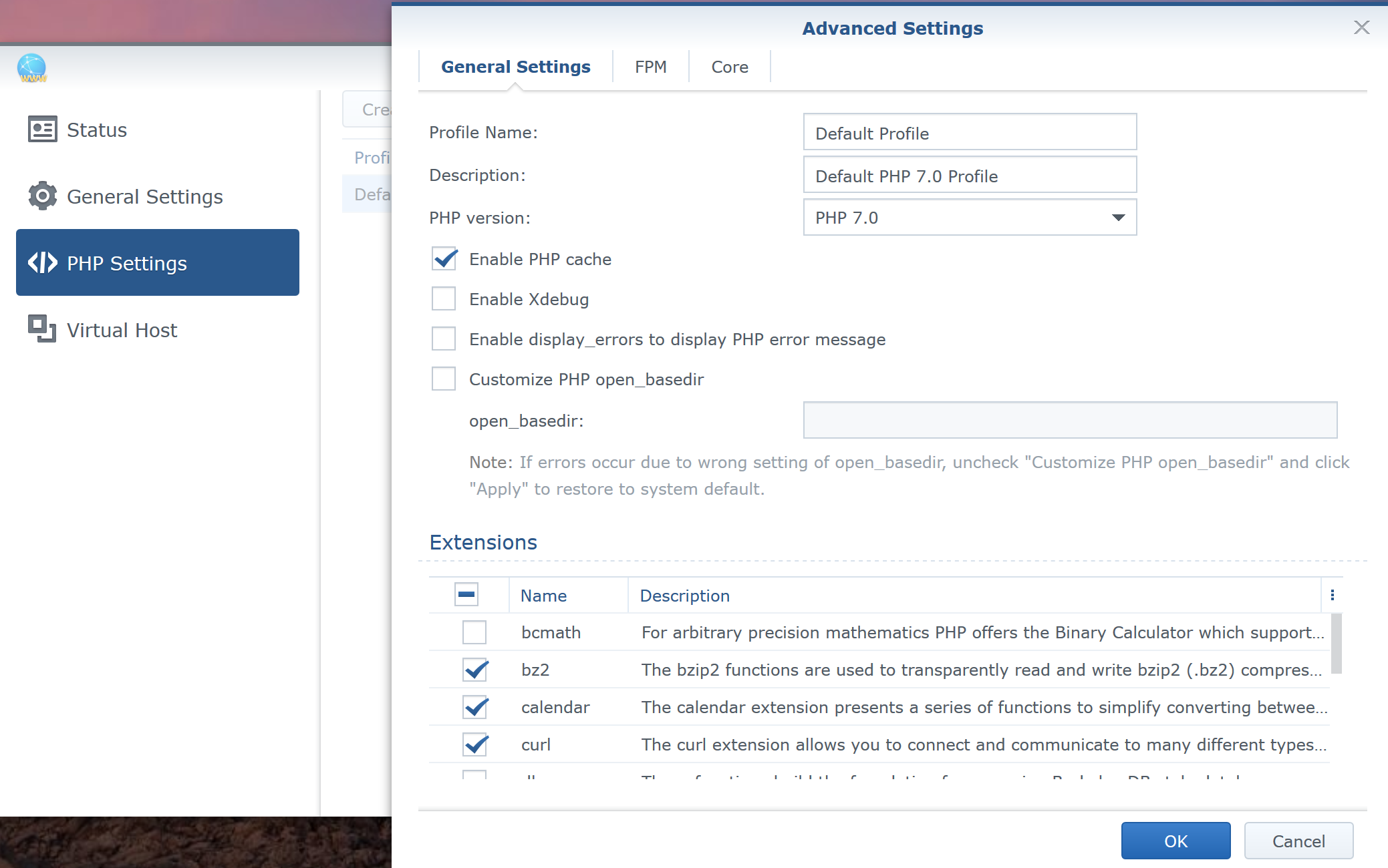

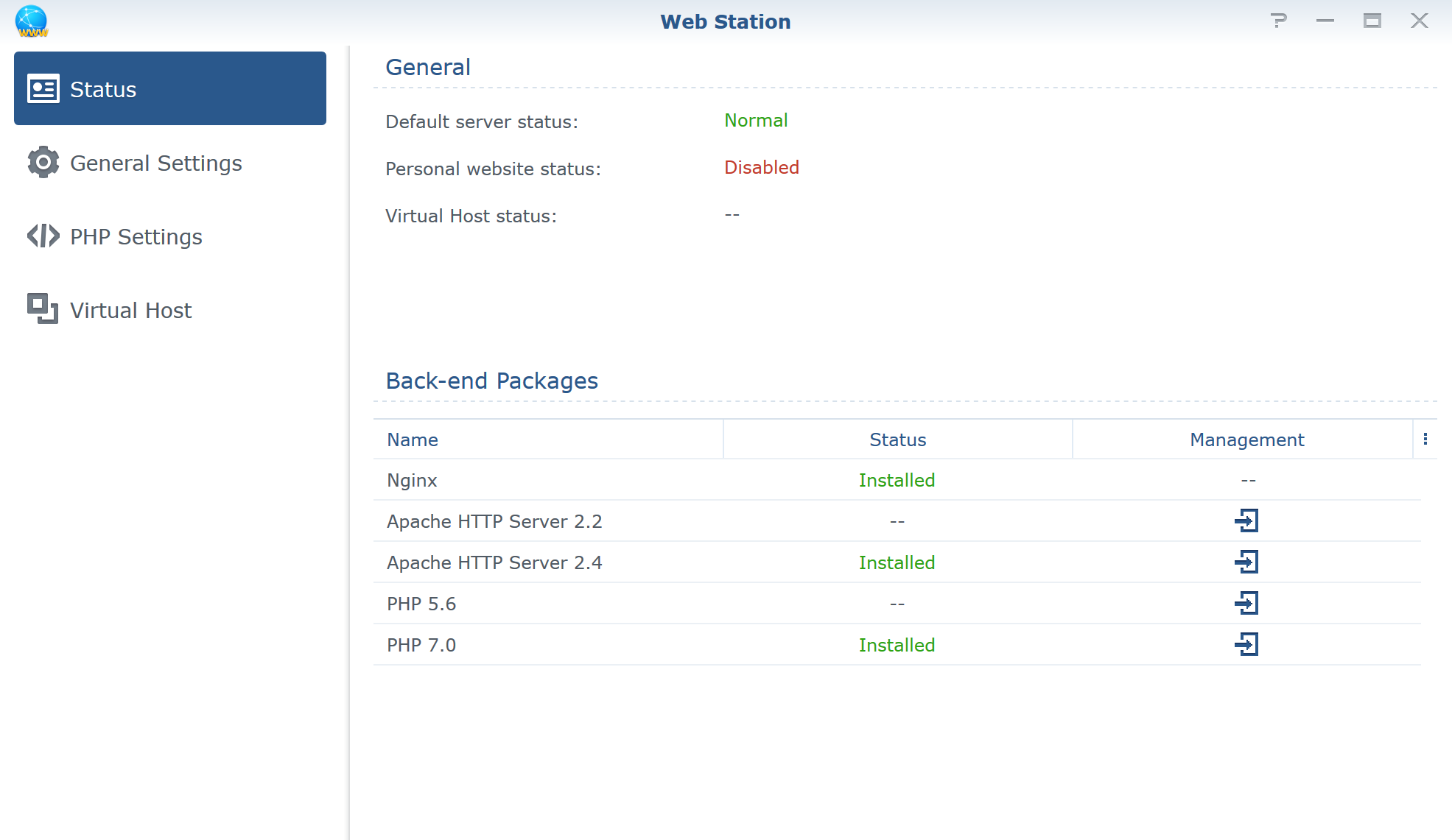

OK, let's drill down on the PHP settings.
What do you have when you click on the Web Station?
Your General Settings?
And, your PHP Settings (Let me know what extensions you have checked)?

Web Station Status is the same as yours, except that Apache 2.2 and 2.4 are installed.
Web Station General Settings also match yours.
In my php 7.0 Default profile, all extensions are ticked except for ssh2.
