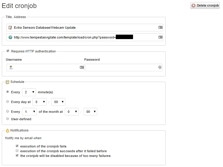

This is what my setup page looks like and runs every 2 minutes. Please note that you do NOT need HTTP authentication, so you can leave that box unchecked. I entered information in there at one time when I first started and was trouble shooting.

did you change the timezone in the image rename script to your timezone?
did you put BOTH the file updateWebcam.php (originally located in the plugin folder) and my image rename file (default name camrenameFC.php) in the /template/load/crons/ folder?
Additionally, a single cronjob command using this format
http://www.auestadhome.com/template/load/cron.php?password=yourupdatepassword
runs ALL the php scripts located in that cron folder. You do not need 2 cronjobs.

Post by proger » Fri Aug 24, 2018 2:02 am
Yes I did.
No I did not. But I have done that now
Also. not sure if you gave up or what, but your block is not updating either.
Course the camera stop sending snaps at 10 pm.
But I have set it go 24 hours a day now.
