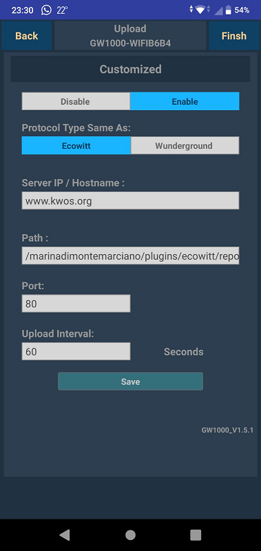

If you want to use the ecowitt plugin you have to configure the gw1000 to upload to meteotemplate:
In your case you should set ( in WsView ):
Server IP/hostname: weather.westfamilynj.net
Path: /meteo/plugins/ecowitt/report/
And in the ecowitt plugin setup ( in meteotemplate control panel ):
Meteotemplate server url ( ex: http://www.example.com ): http://weather.westfamilynj.net/meteo/api.php
( this is the only important setting in the plugin )
MJW

Thanks, I have WSView and the plugin set up that way.
When I did the test - http://weather.westfamilynj.net/meteo/a ... =10&LT=yyy, I did get the expected "success" and 1 lightning strike shows up in the lightning block. I just can't convince the GW1000 to automatically connect to my server, to populate everything else. It sends data to the Ecowitt network just fine, so I know it is working.
