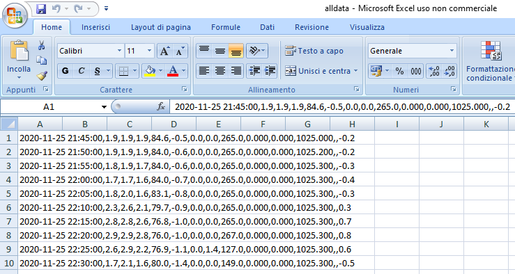

So, now I have the "alldata" csv file shown in the following image.
alldata pic.PNG (48.63 KiB) Viewed 20738 times

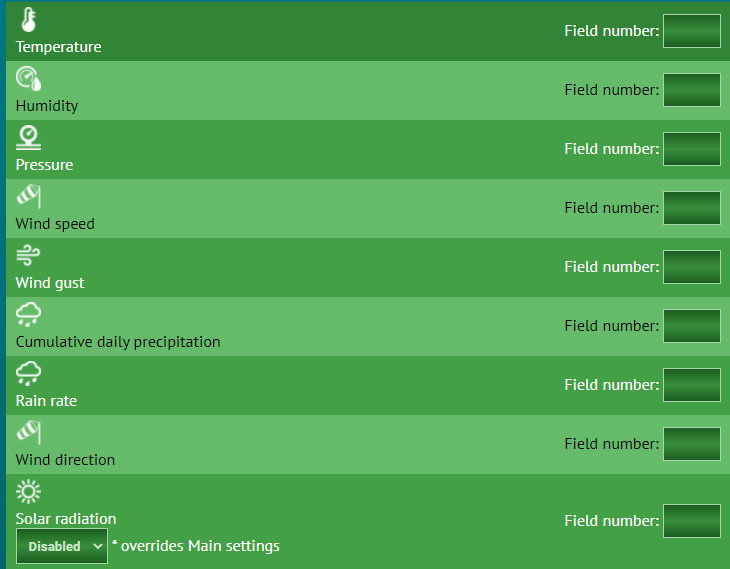

What have I to put in the tabs?
Sorry for the, maybe, stupid question.
Thank you.

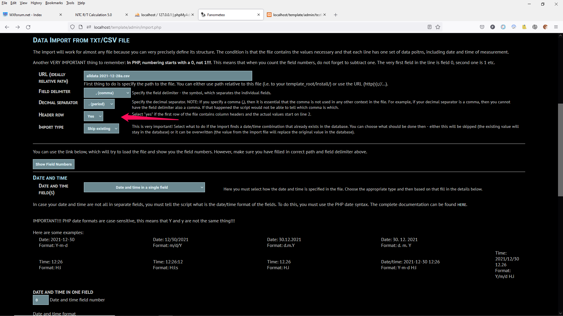

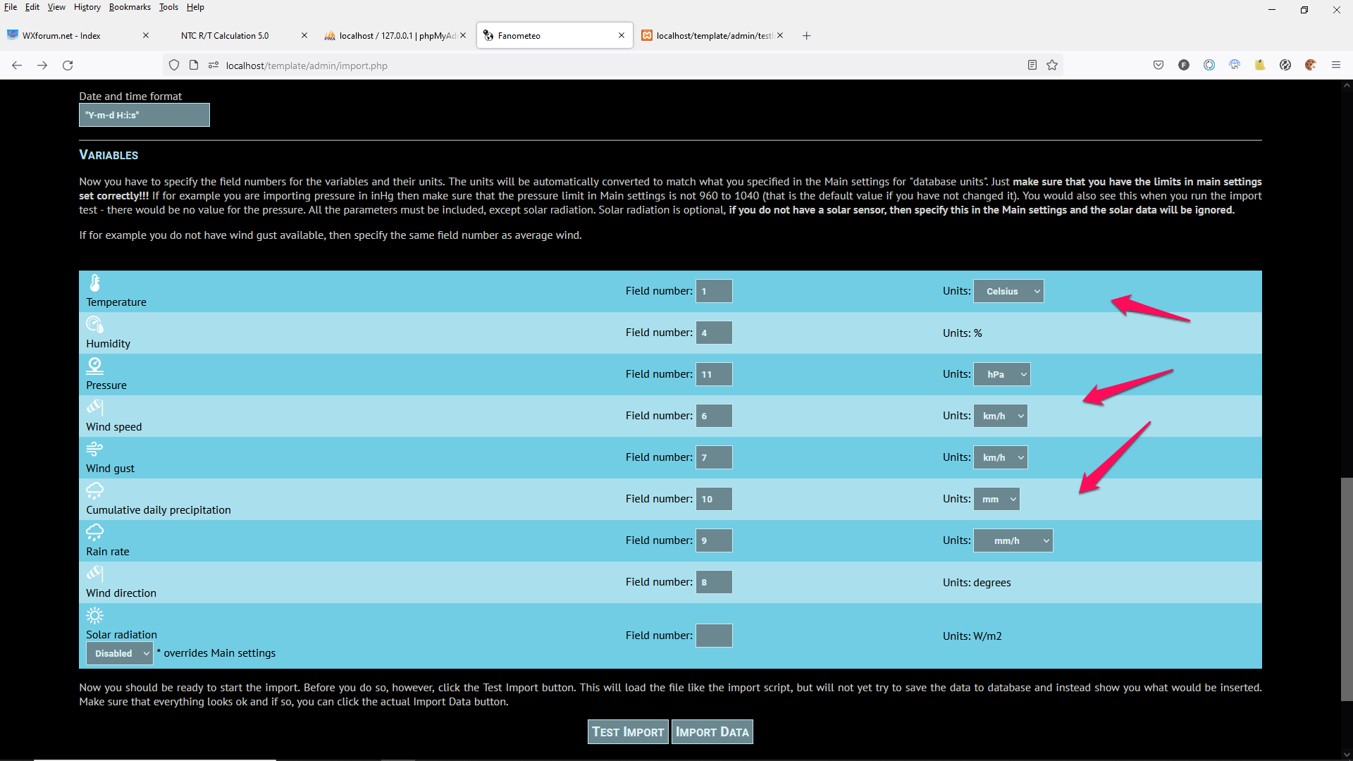

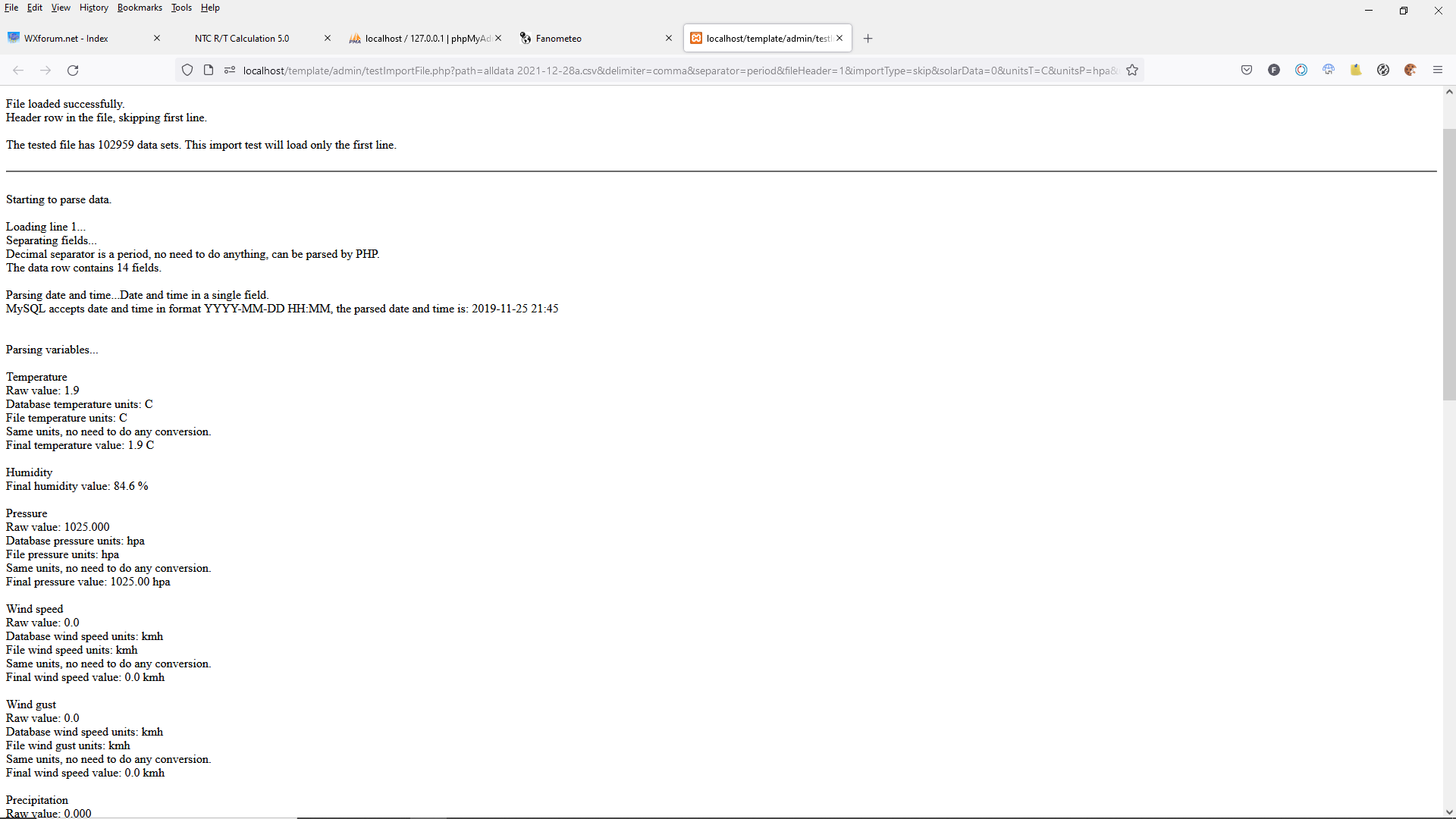

Re: Loading Meteo Station Data in Server Folders
Post by davidefa » Thu Dec 30, 2021 2:04 pm
I added an header to your data ( if you import your data without header simply set 'Header row' to No ) and imported using the following settings:
( check if the column naming is correct, set the unit of measure as required )
when you click 'Test import' you should see something like this ( do not consider the year, I had to change it, but it is correct in your data ):
www.davidefabbri.net/files/alldata_2021-12-28a.csv
