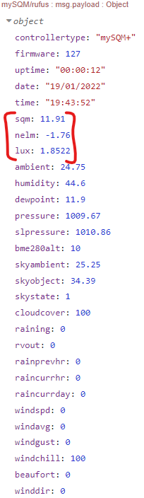

Hi folks,
I have a custom build weather station that is sending the following list of sensor data. I am able to integrate the Ambient Temperature, Humidity, Dewpoint, and Pressure in the meteotemplate database. I was wondering how I could integrate the rest of the data, especially the Sky Quality Measurement (SQM), Near-Eye Limiting Magnitude (NELM), and LUX?
Screenshot 2022-04-19 155640.png (27.08 KiB) Viewed 6698 times
Thanks in advance for any help.
Jairo

- every field you pass to api.php will be reflected ( and accessible ) in the file meteotemplateLive.txt
( this file is used by blocks that need last/instantaneous values )
- if you want to save these new fields in the database ( table alldataExtra ) you have to modify: api.php, update/apiSetup.php and update/saveAPISettings.php
( comparing the original files with this version which have a few sensors added, you can easily see what to modify )
Next step is to modify blocks and plugins to access your new fields...
If you want, you could use the solar radiation 'S' field to store the lux reading ( my weather station has a luxmeter sensor and converts, or approximates, the reading to w/m2 )
If you have a link to a description of your station/sensors/software, please, share
Please add a link to your site ( for example in your contact informations )

Would it be much to ask if you could modify the api.php, apiSetup.php, and saveAPISettings.php for at least one data, e.g., the SQM data? I can then use the PHP files as a guideline to integrate the other data. :)

Added SQM ( check limits... in api.php near line 902 )
