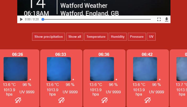

There is a link to my Bloomsky page below, let me know how it compares with yours, bare in mind if you have only just hooked it up it will only start showing images from this day forward. Can you include a link to your site.
http://www.watfordweather.co.uk/plugins ... /index.php

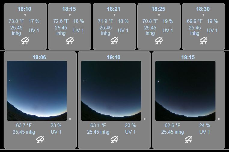

The icons below your large static image and the calendar should be filling with a square still frame (thumbnail), the size of which you choose when setting up the plugin, I have my thumbnail setting on 100px and the image update interval on 300s (as the image is updated every five minutes).
- BS Thumbnails.JPG (51.98 KiB) Viewed 61545 times

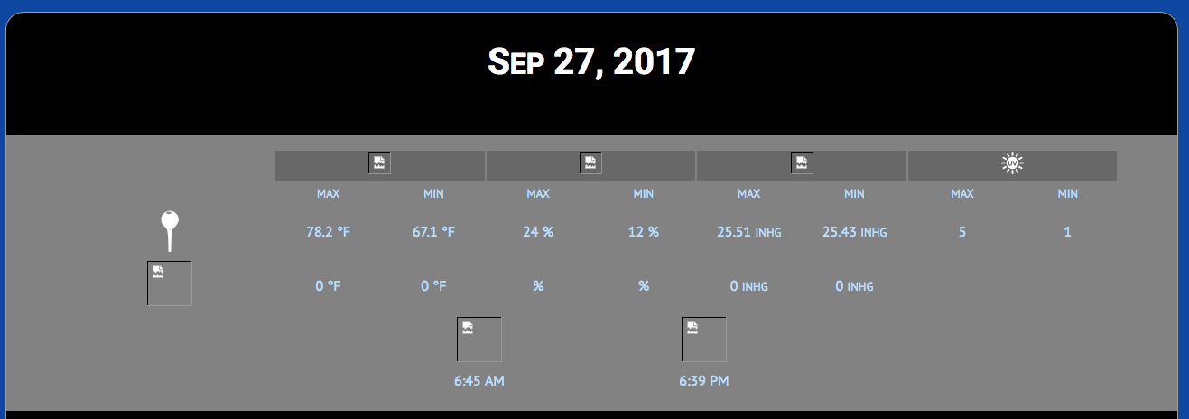

Thank you. Version is correct. I modified the update time to 300 seconds and reduced the size to 100. The picture looks better.
How can I show the data from my Blomsky like yours? Do I need to wait? I am willing to beta test.
As it is right now, it’s useless since the main page doesn’t show any data from my pws.
Also, when I run the template test, everything is green except for the API file. I don’t know how to fix that.
Plus, some of the control panel icons are not showing up (I can share later on)..

The other good news is that your thumbnail pictures are now starting to show up:
- Orbie and Stormie.JPG (44.28 KiB) Viewed 61515 times

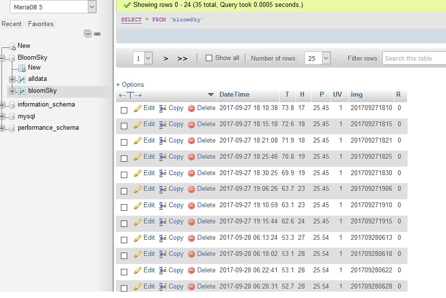

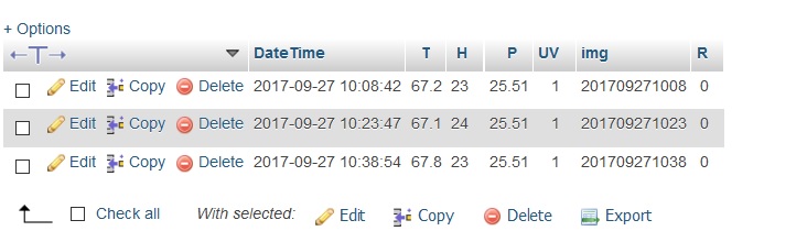

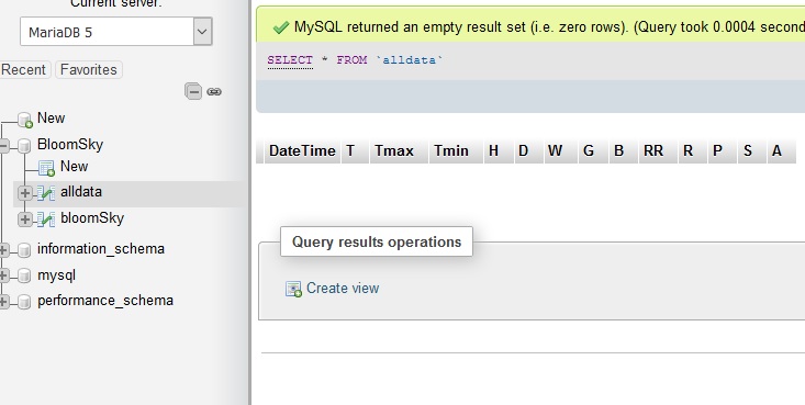

EDIT: It's still showing offline on my main page. On my Bloomsky page, it's receiving data. Is there something that I need to perform?
Was the update supposed to utilize the BloomSky database? The alldata database is still empty.

Hi Fraggboy, just a little confused between this thread and the other you have called 'API File not found..' The other thread sounds like you want Weather Underground as a source and this one you want your Bloomsky - is that correct? Assuming this to be correct you have two sites?
Coming back to this thread now, have you set up a CRON job separate to the one for downloading images and video clips? You need to do this in order to receive the data from your Bloomsky station to feed Meteotemplate.
If you're not sure about setting this up let us know.

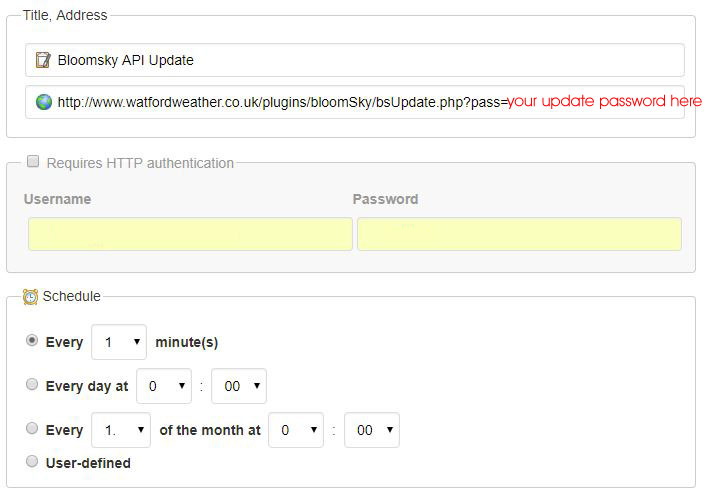

My apologies for not fully understanding. I *do* want view all data from my BS only (Only have 1 site). I don't know which blocks are "BloomSky" compatible.
I do have one CRON job setup to download the videos/images/data from my BS. Did I forget to add a second one?

Yes you need to setup a separate CRON job.
1. I'm going to assume you have the bsUpdate.php file in your www.yourwebsite.com/plugins/bloomSky folder. Jachym released this earlier today should you need to update it.
2. Now setup a new CRON job, look at the image below and use it as a guide (needless to say replacing my details with yours) See how you get on and let us know.
- BS-Cron-Update-Data.jpg (39.29 KiB) Viewed 61482 times

That's what I was missing! You guys are awesome! Seriously.
So, I need to dig a bit deeper into the code.. When you click the more on the current condition block, the text is pretty big. I guess that block is designed with more landscape in mind..
I am seeing that the UV is off. Maybe it needs more data so I will let it run for a bit.
