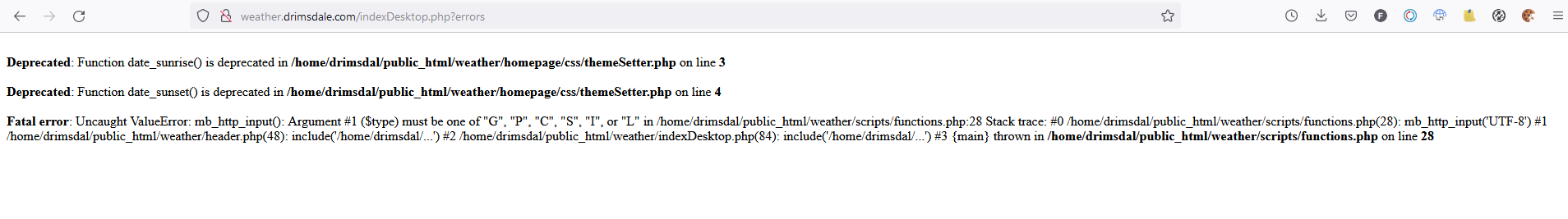

Post by davidefa » Wed Dec 07, 2022 9:32 pm
This is the error returned by your home page:
You can comment line 28 in the scripts/functions.php file ( just add a // at the beginning of the line )
This line should give no problem in php 7 but returns a fatal error in php 8.
Check if your hosting provider switched to php 8, in this case this fix will not solve all of your issues.
If you can switch back to php 7 you should be ok. If you have to stick to php 8 check this post: http://www.meteotemplate.com/forum/view ... 170#p11828

Post by Brutha » Thu Dec 08, 2022 8:05 am
Brutha wrote: Mon Dec 05, 2022 8:18 am Check if your hosting provider switched to php 8, in this case this fix will not solve all of your issues.
Bingo! Yes, that was it....
My domain is on PHP 8, but I had previously set the weather subdomain to php 7 instead of inheriting 8 from the main domain.
It seems they removed that exception, maybe some upgrade: putting the exception again fixed it, and we're back up and running now!
