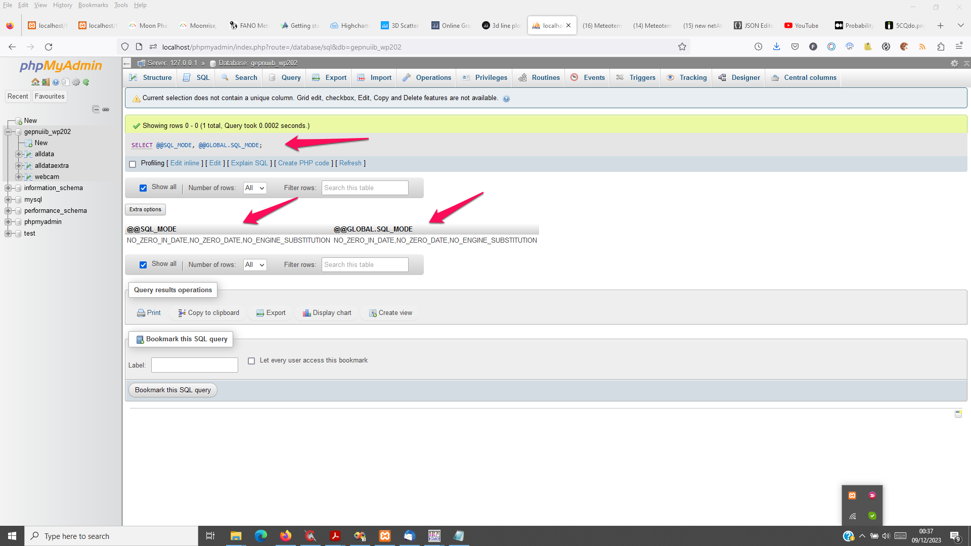

The page you posted is relative to the php settings.
This is a settings of mysql
For example in phpmyadmin, select your database and in the sql tab execute the following query:
SELECT @@SQL_MODE, @@GLOBAL.SQL_MODE;
Check in the result if the flag is present, in my local database is disabled:

davidefa wrote: Fri Dec 08, 2023 11:39 pm The page you posted is relative to the php settings.

No, this is only to check if the flag is enabled ( didn't see you already solved the problem ). So disregard my last reply.

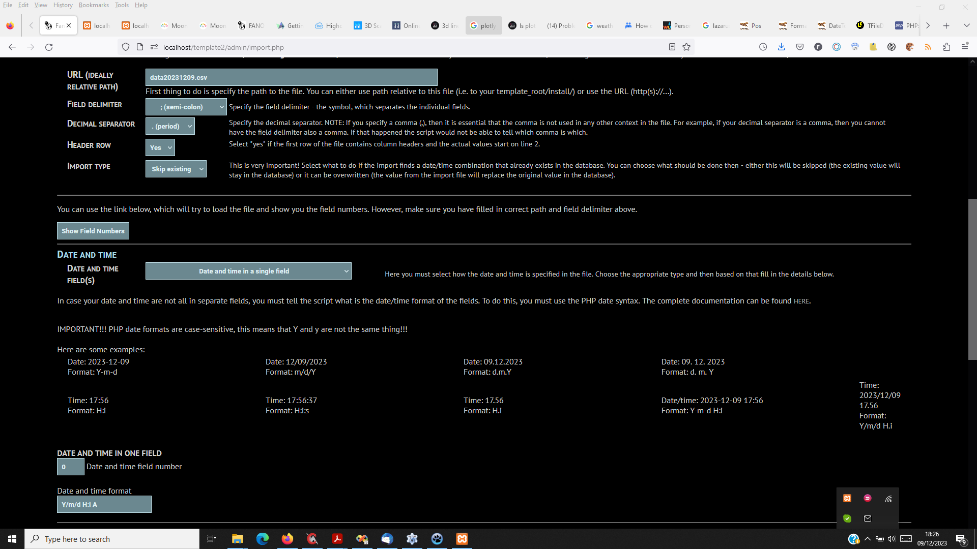

If you have a backup of the data ( in csv format ) you can import the missing data via the meteootemplate control panel.
Post your csv data and I'll show how to configure the importer.

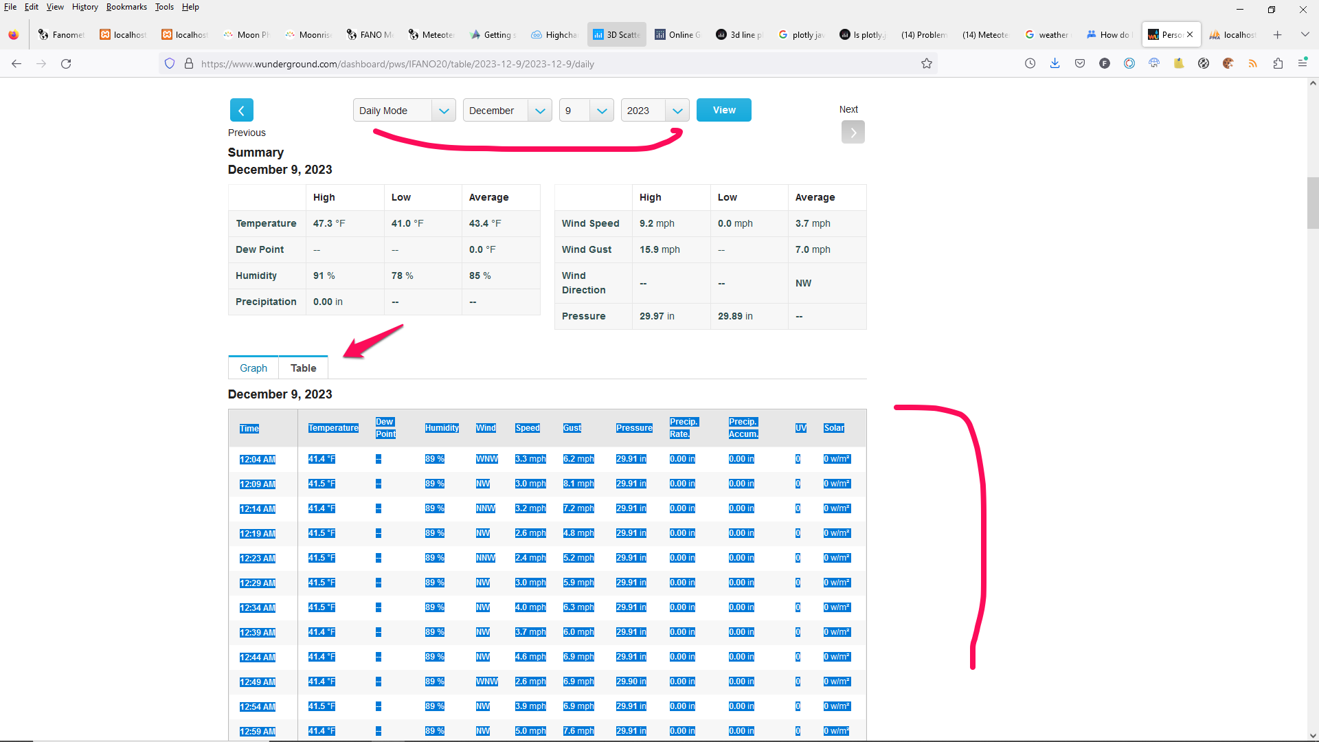

If you have a 'WeatheLink Live premium super pro' subscription ( sorry can't understand the davis naming ) you should be able to make a backup from their services.
If not you can use the small utility I've written to extract the data from the wu page ( one day a time ) and convert to csv ( after a small filtering ), once converted you can import in meteotemplate
Usage is simple:
- on the wu page, select the day you want import, the tab 'table'
- select all the table, copy and paste in the edit area of the utility ( wu2csv )
- in the utility select the appropriate date ( which is not included in the data pasted ), and click the button save

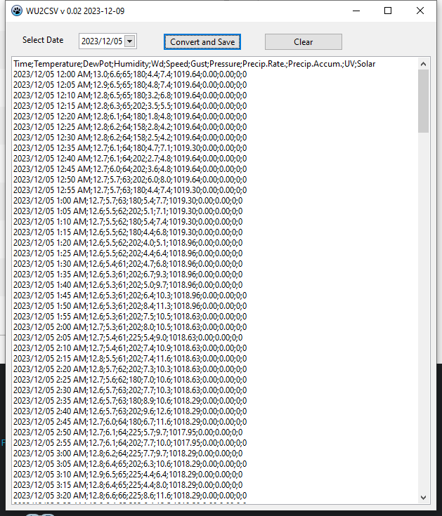

Hi Davide,
Tried it now using your program, but when I go to manually upload the .csv file it gives me errors, is this normal?
I'll attach them below in the screenshot

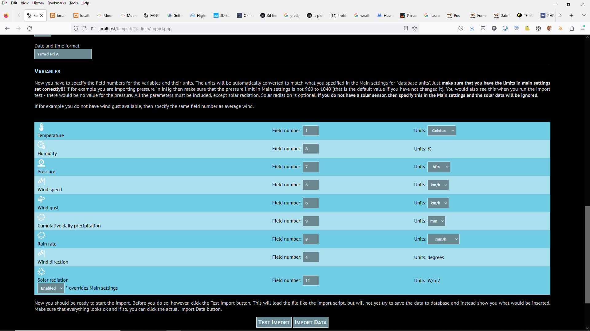

I have posted also the import configuration... but I can't see the post ( maybe I forgot to click the submit button after a preview ).
So here the configuration:

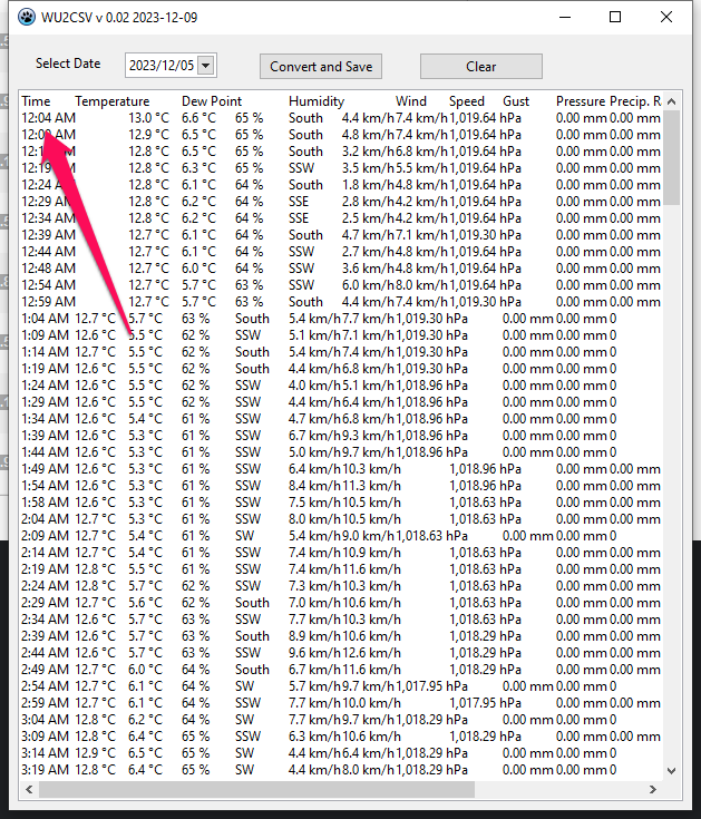

No the conversion isn't ok ( the rows do not begin with the date ).
When pasting the data, the first line should start with: Time
I updated the script as forgot the conversion of the 'South' direction
This is after the conversion ( 5th of December ):
