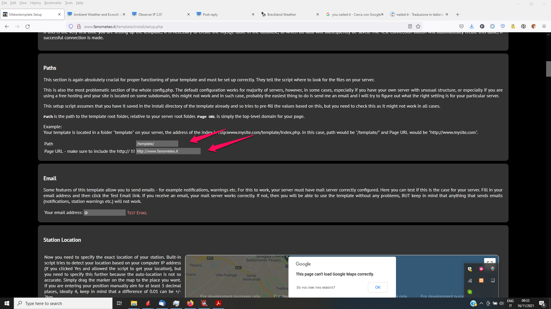

Yes this is due to the 'automatic http to https redirection' enabled by your hosting provider.
For the main setup of meteotemplate, you have only to change the 'page URL' setting from
http://www.eyesontheweather.com.au
to
https://www.eyesontheweather.com.au
( you have only to add the 's' to the initial http )

( if you are unable to access the main setup, you can do the same editing directly the config.php file, near line 21 edit the $pageURL variable value, consider that this file is 'vital' for meteotemplate and messing with it is not a good idea, so a backup could be advisable )

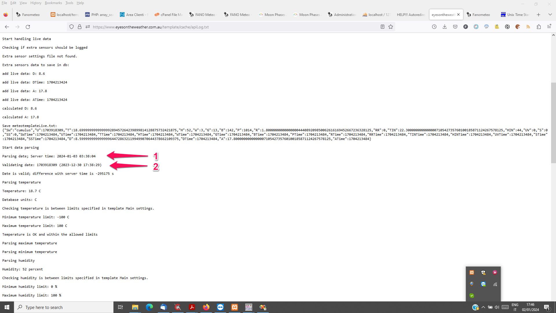

Your cache/apiLog.txt shows that the cron job ( that executes update/update.php ) is run correctly every minute, but the realtime.txt is not updated and contains stale data ( 2023-12-30 17:38:29 ).
So the issue should be in the 'cron job' that uploads the realtime.txt to your template site.
