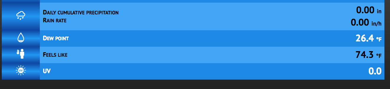

UV is not reporting correctly
Fraggboy
Posts: 193
Location: Sunny California
Software: Bloomsky
Post by Fraggboy » Sat Sep 30, 2017 8:16 pm
So, I've noticed that all areas of the webpage is not showing the correct UV. I even checked the api data, and it's showing 0.
There is a difference between Sky I and SKY II's. SKy I had the UV sensor on the Sky. The Sky II's UV sensor was removed due to the storm having this sensor.

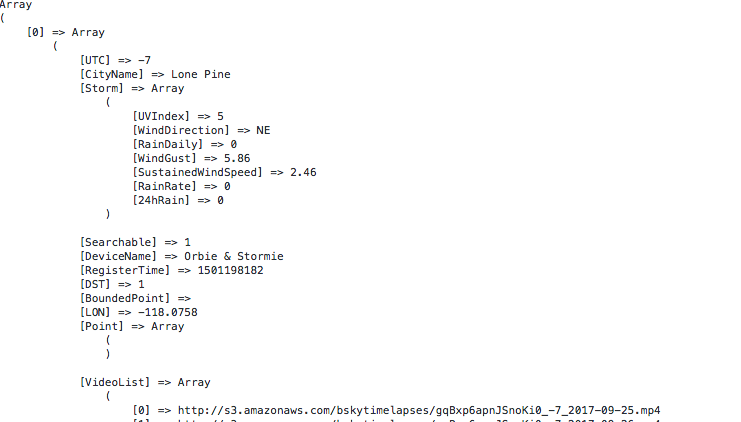

Here is a pic of the api data:
Screen Shot 2017-09-30 at 1.14.06 PM.png (40.5 KiB) Viewed 50654 times

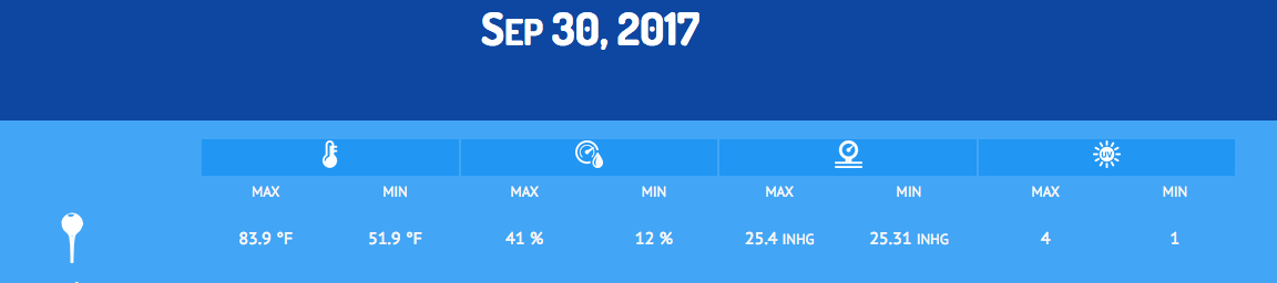

What I have found out, is when I go to my Bloomsky page, and select today's date, I do see the actual UV reading..
Screen Shot 2017-09-30 at 2.42.44 PM.png (32.42 KiB) Viewed 50645 times
I check dayOverview.php file and I do see that it's fetching the data from the database, thus being correct.

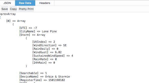

I understand that BS has had issues with their servers, but when I navigate to the URL to update the api, the UV is showing correctly in the data.
Screen Shot 2017-10-01 at 3.57.30 PM.png (43.22 KiB) Viewed 50587 times

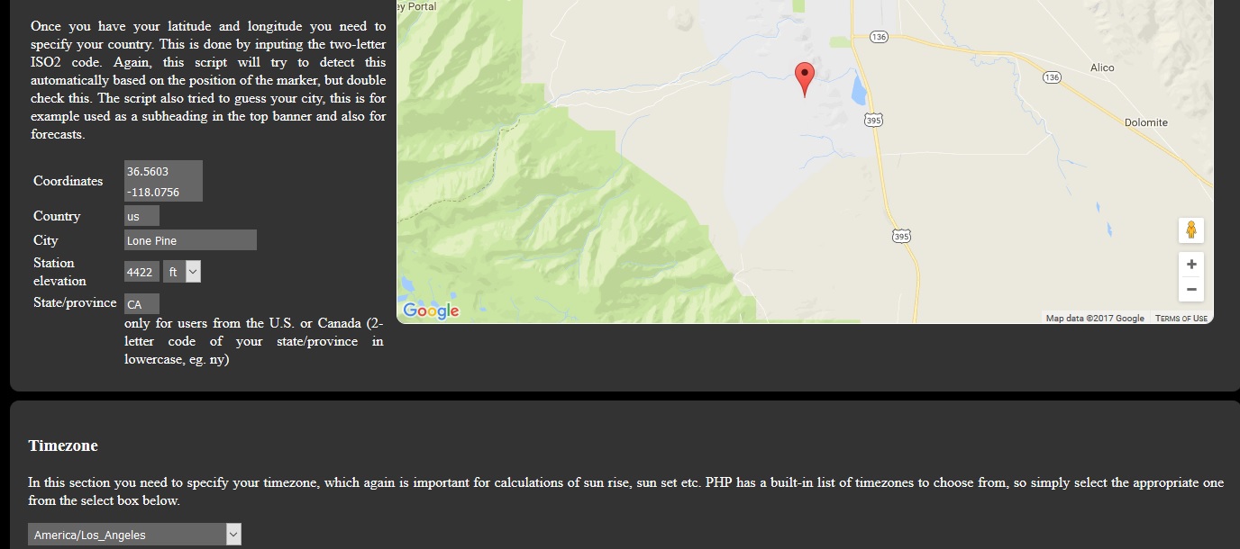

Thats strange though because the sunrise/sunset times should be correct for your location, unless you provided incorrect GPS
Fraggboy
Posts: 193
Software: Bloomsky
Re: UV is not reporting correctly
Post by Fraggboy » Mon Oct 02, 2017 12:15 pm
I agree it’s strange.
Coordinates are correct. It’s pin-pointing my location correctly on the map.
Post by Jachym » Mon Oct 02, 2017 1:04 pm
Is TZ set correctly?
Fraggboy
Posts: 193
Software: Bloomsky
Post by Fraggboy » Mon Oct 02, 2017 1:19 pm
Everything is correct on my end. I don't think you need to look into this. There isn't a huge drive from Bloomsky users.. :)
