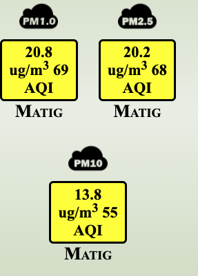

Re: new airQualitySensor block ( updated airQualityEcowitt )
Good day to you,
I have just seen the file, there are now 3 sensors, only it seems that 1 and 3 have been swapped, PM 1 should show a lower value and PM 10 a higher one, it is the other way round.
Gerrit
Gerrit
- Schermafbeelding 2022-04-01 om 13.56.39.png (42.83 KiB) Viewed 68111 times
- Schermafbeelding 2022-04-01 om 13.49.26.png (9.22 KiB) Viewed 68112 times
- Schermafbeelding 2022-04-01 om 13.48.03.png (41.24 KiB) Viewed 68112 times
mchd17
- Posts: 196
- Joined: Sat Mar 17, 2018 2:01 am
- Location: Illinois
- Station model: Davis Pro2 Plus
You can assign PM1.0 PM2.5 PM10 0 with the air quality block settings.
I had to switch PP3 and PP1.
Gerrit
- Posts: 39
- Joined: Wed Feb 06, 2019 1:31 pm
- Station model: Vantage pro 2 plus
Good day,
That was not a smart move on my part
It works fine now
It works fine now

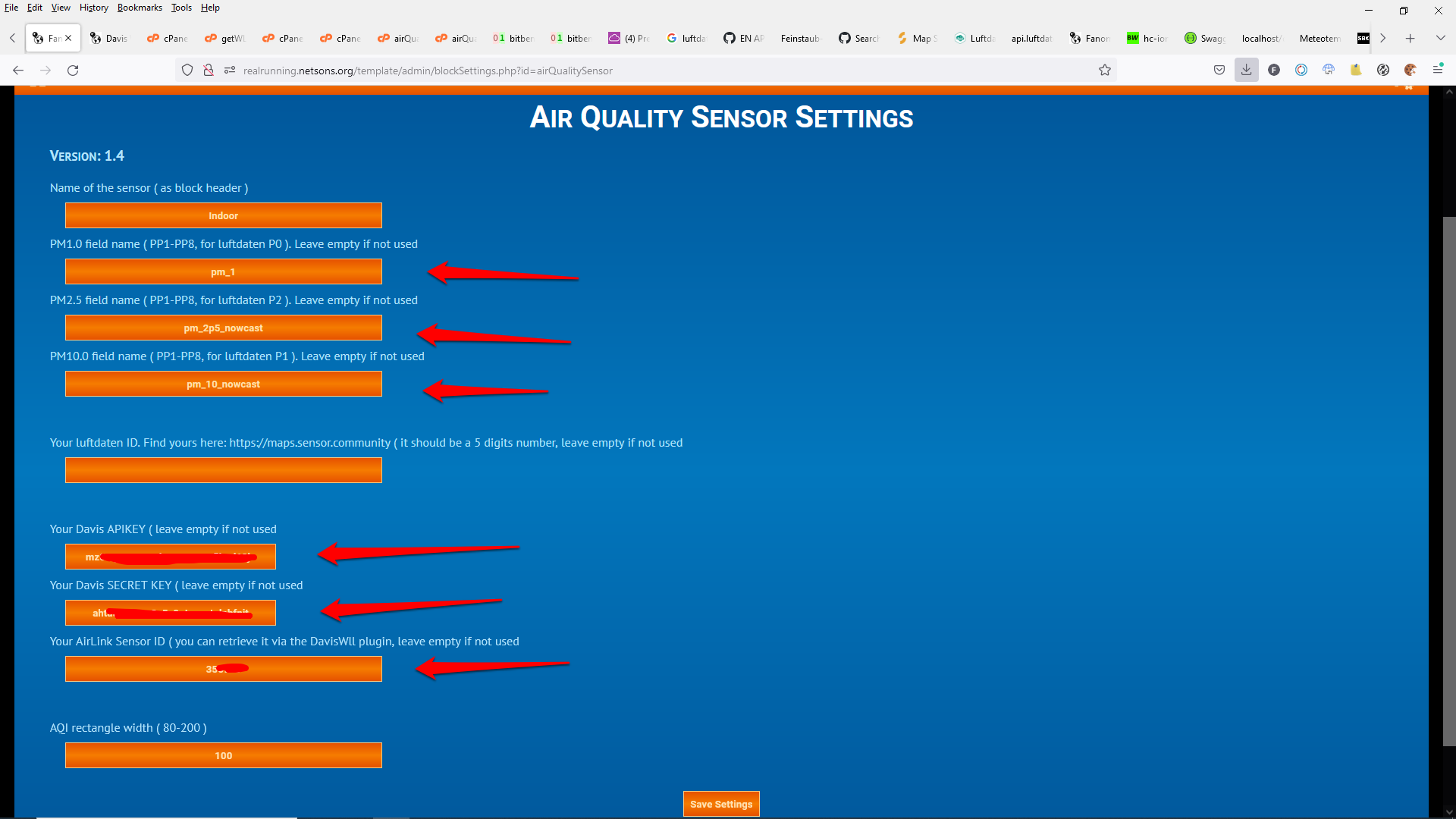

v1.4
- added luftdaten support ( retrieves pp data directly from luftdaten.info )
- added davis airlink support ( retrieves pp data directly from weatherlink.com )
luftdaten configuration:
- add your lufdaten sensor Id
- in PM1.0 field write P0 ( if available )
- in PM2.5 field write P2 ( if available )
- in PM10.0 field write P1 ( if available )
davis airlink configuration:
- add your davis api key and secret key
- add your sensor Id ( lsid you can retrieve it via the davisWLL plugin )
- in PM1.0 field write pm_1 ( if available )
- in PM2.5 field write one of the available davis field, pm_2p5_nowcast for example
- in PM10.0 field write one of the available davis field, pm_10_nowcast for example
NOTE
To retrieve data from the database simply leave lufdaten sensor Id and davis api key empty
Purpleair support could be added as well ( but need a purple air api key to test it, as old api does not work any more )

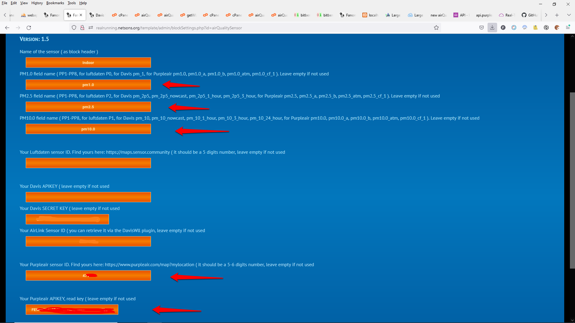

v1.5
- added Purpleair support ( retrieves pp data directly from purpleair.com )
purpleair configuration:
- add your purpleair api key ( the read key )
- add your sensor Id ( you can retrieve it via the purpleair map: https://www.purpleair.com/map?mylocation )
- in PM1.0 field write one of the available purpleair field ( pm1.0, pm1.0_a, pm1.0_b, pm1.0_atm, pm1.0_cf_1 ), pm1.0 for example
- in PM2.5 field write one of the available purpleair field ( pm2.5, pm2.5_a, pm2.5_b, pm2.5_atm, pm2.5_cf_1 ), pm2.5 for example
- in PM10.0 field write one of the available purpleair field ( pm10.0, pm10.0_a, pm10.0_b, pm10.0_atm, pm10.0_cf_1 ), pm10.0 for example
- airQualitySensor_1.5.zip
- (46.42 KiB) Downloaded 1144 times

i've just installed this block but i don't understand how to catch data from sensor.
I've PurpleAir sensor already installed.
In settings page there is no url or IP field to catch this data.
Any help please?
Alessandro
You have to enter your 'Sensor ID' and 'Api Key' ( [s]you can generate your api key from the control panel on the purepleair site[/s]* ).
It works by retrieving the data directly from the purpleair cloud ( as your sensor already sends data to the purpleair cloud ).
Retrieving the data directly from the sensor can be done only if the server and the sensor are on the 'same network' ( that is not your case ). It is not supported in this release, but it can be added if someone needs.
NOTE
* you have to request an api key to contact@purpleair.com
NOTE

Thanks for reply Davide,davidefa wrote: ↑Sat Jul 30, 2022 11:14 am You have to enter your 'Sensor ID' and 'Api Key' ( you can generate your api key from the control panel on the purepleair site ).
i don't manage to find my control panel on purpleair site and also api key generator.
Could you send me direct link?
I've red that the only way to obtain api key is to send an email to purpleair.com.
Thanks in advance,
Alessandro
My bad, you are right ( I don't have a purpleair unit, I got confused having managed davis and ecowitt api key ).
According to this post you have to request an api key to contact@purpleair.com.
