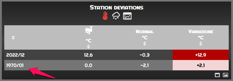

i've installed history block on this site: https://meteofirenze.eu but i've an issue.
It shows too years than normal and i don't know why.
Ani ideas?
Thanks in advance.
Alessandro
Re: History block shows too years than normal
Post by davidefa » Tue Dec 06, 2022 11:04 pm
I think the problem is you have a record in the database dated 1970.
You should delete it via phpmyadmin.
