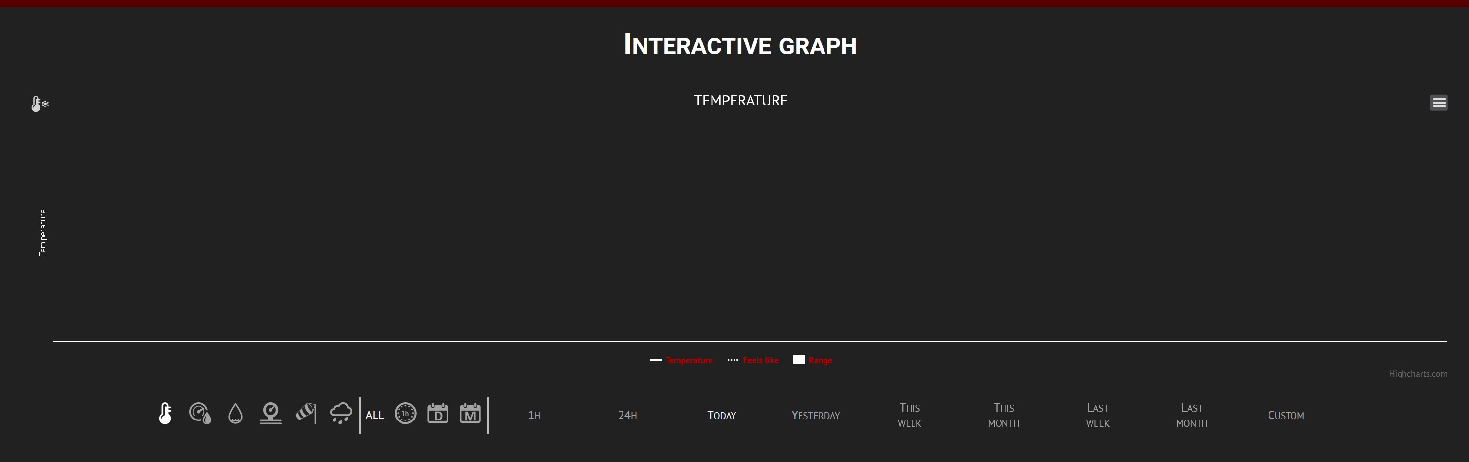

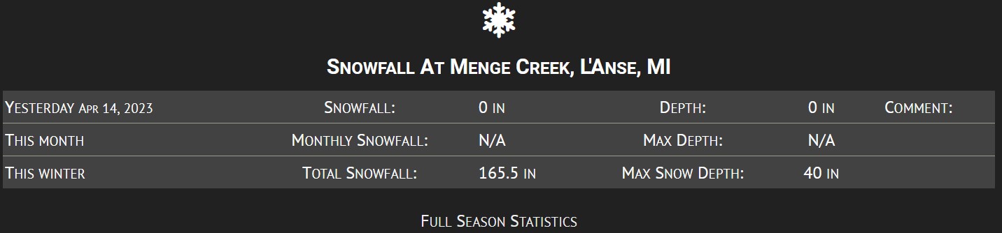

My hosting company had to move my site to a different server, and since then blocks and plugins are not calculating correctly. All the data is in MySQL and updating correctly. Some blocks show some data, but others show nothing.
In attached screen shots, the snow block show the correct total snowfall, but is missing the monthly, and in the interactive graph screen show it shows nothing at all. This is the first time I've had any problems at all.
Any ideas how to fix this?

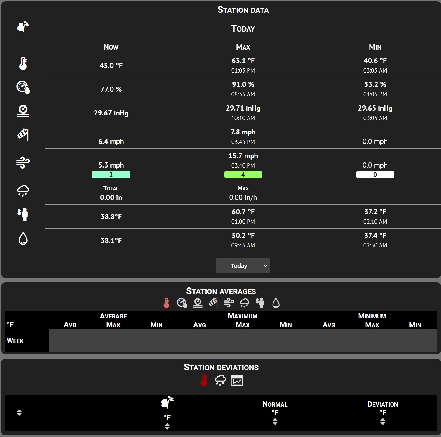

Here are a couple more examples. As you can see the Station Data is up to date and correct, but the Averages and Deviations are blank.
