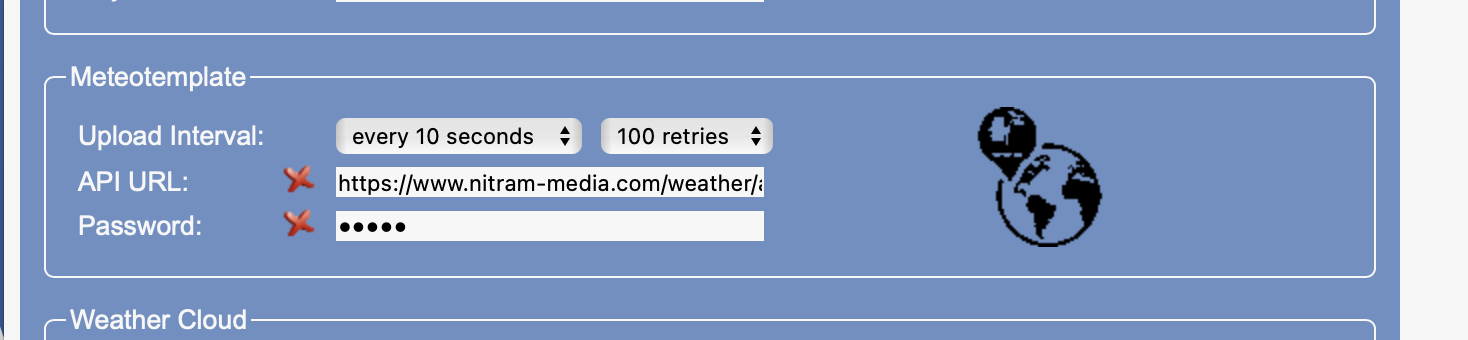

I can’t get my station to connect (Meteobridge 6.0)and send data to the api, I am up to date with the template and I am using php 8.2.
Any help would be great.
Can't connect to the api

- Screenshot 2024-07-08 at 1.05.08 PM.png (66.59 KiB) Viewed 16027 times
