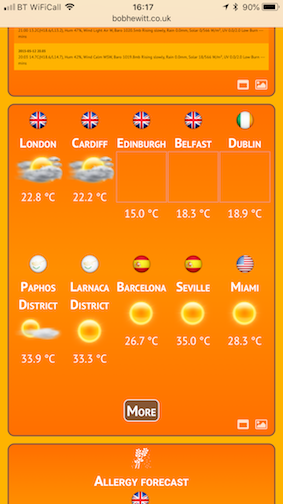

Can anybody tell me why my block is not producing all the weather condition icons. As you can see I have 3 missing on my Desktop version.

You are missing at least one of the icons.
It sholud be in the following directory
http://bobhewitt.co.uk/pictures/WeatherDisplay/Meteotemplate/homepage/blocks/worldWeather/icons/overcastD.png
You can FTP that to your site for a fix. You should have a copy of the block files locally, or at worst download the block files from MT.

Yes, overcastD was missing for some reason so a download fixed it.
Many thanks for your help.
