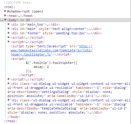

Me either. When I try and see the page it is pretty empty:
Yours:
Mine:
I have no clue.
