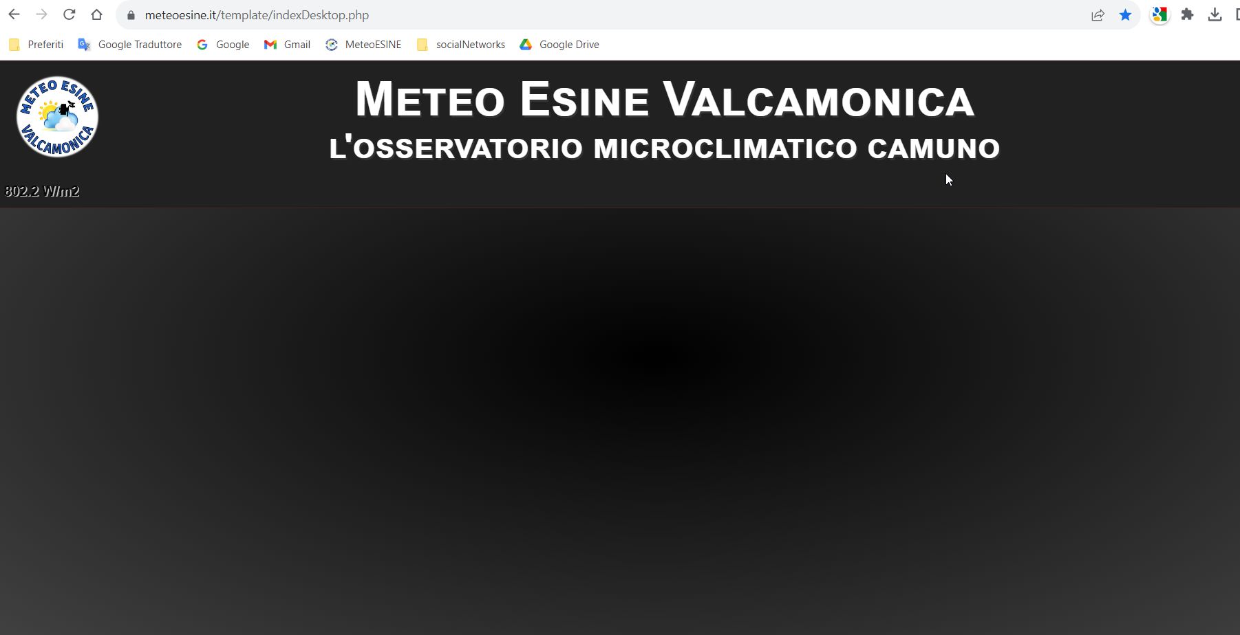

I too have a similar problem:
if I use php 8.1: I only see the header, with php 8.2: http error 500,
running well with php 7.4

Re: HTTP ERROR 500 - update from 18 to 19.
this is really strange, it seems to work for some and not for others. My demo page is running PHP8.2 without any issues and the two people to whom I sent it to test also reported no issues.
Can you please someone post a link to the non-functional page so that I can try to see where the error is coming from?

I did the update.
Just a blank page on php 8.2
Works except one block on php 8 & 8.1
All working fine on php7.4
I hope I found the issue, please try replacing the content of scripts/functions.php with the one below.
Please let me know if it helped.

I downloaded the file but I still get the http error 500 on only php 8.2.
can you please send me a link to where you see the error? This is really strange since there are only very minor changes between 8.1 and 8.2. It could be some caching issue, but I need to see the error.
