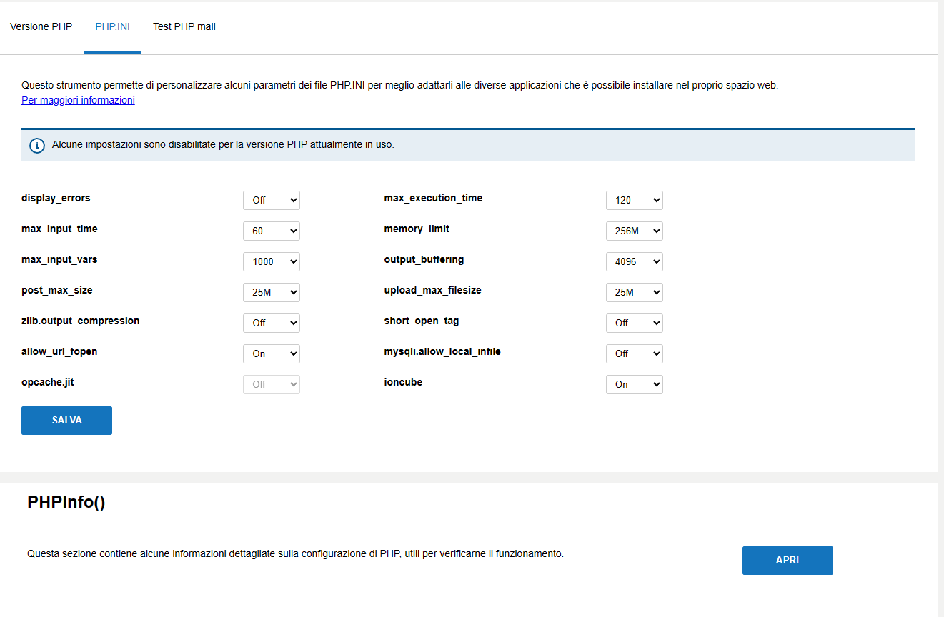

From the admin panel in the php management, there is the management of the php.ini file which I attach below in the screen, but the indicated entry does not appear to be there.
See if it could be one of those shown in the photo.

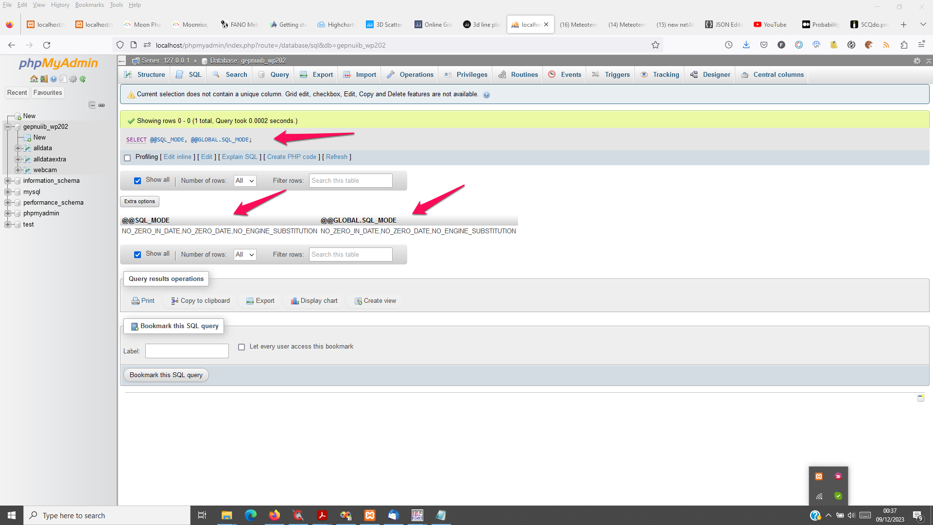

Re: Problem Php 8.2 homepage admin
The page you posted is relative to the php settings.
This is a settings of mysql
For example in phpmyadmin, select your database and in the sql tab execute the following query:
Check in the result if the flag is present, in my local database is disabled:
SELECT @@SQL_MODE, @@GLOBAL.SQL_MODE; -
No, this is only to check if the flag is enabled ( didn't see you already solved the problem ). So disregard my last reply.

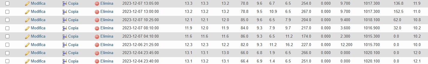

unfortunately I checked better, the database via phpmyadmin is actually a data hole from 23.45 on 4/12/2023 until 13:00 7/12/2023, attached is the part where there is the hole in the database, can I recover this data via weather underground?

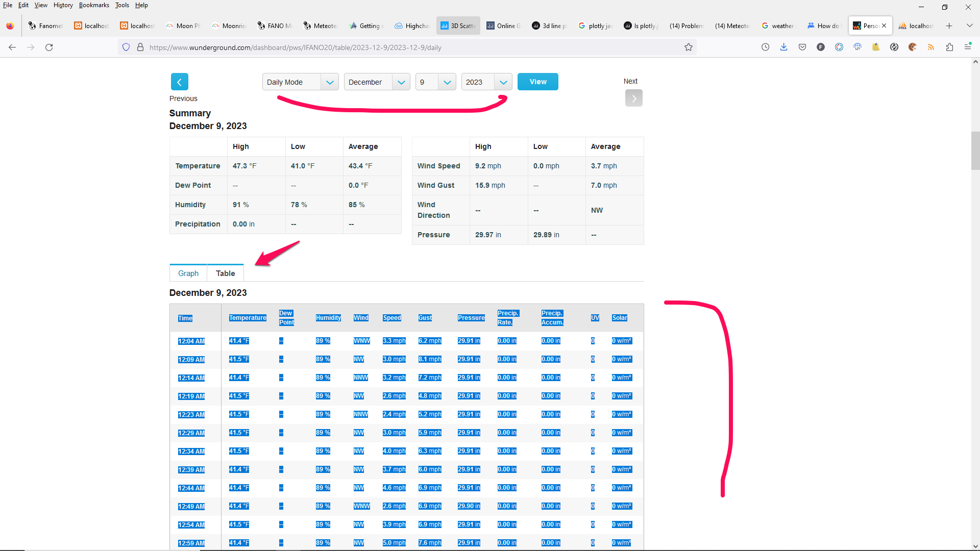

To check your database I can recommend the 'data quality control' plugin ( helps identifying problems, data inconsistencies... )

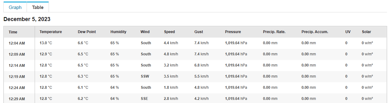

If you have a 'WeatheLink Live premium super pro' subscription ( sorry can't understand the davis naming ) you should be able to make a backup from their services.
If not you can use the small utility I've written to extract the data from the wu page ( one day a time ) and convert to csv ( after a small filtering ), once converted you can import in meteotemplate
Usage is simple:
- on the wu page, select the day you want import, the tab 'table'
- select all the table, copy and paste in the edit area of the utility ( wu2csv )
- in the utility select the appropriate date ( which is not included in the data pasted ), and click the button save
Usage is simple:

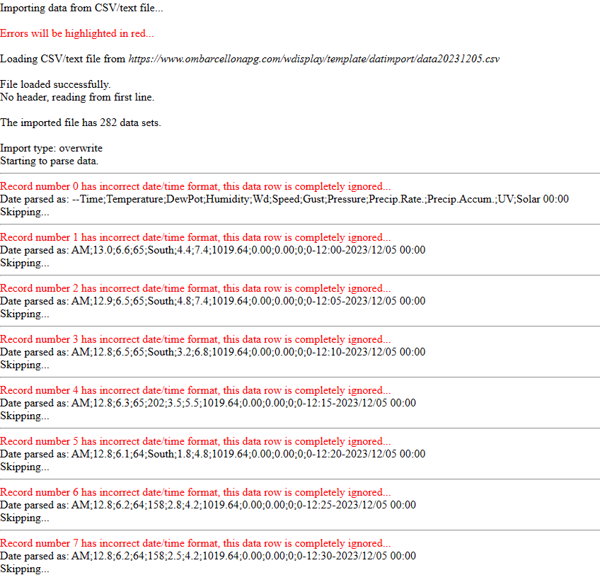

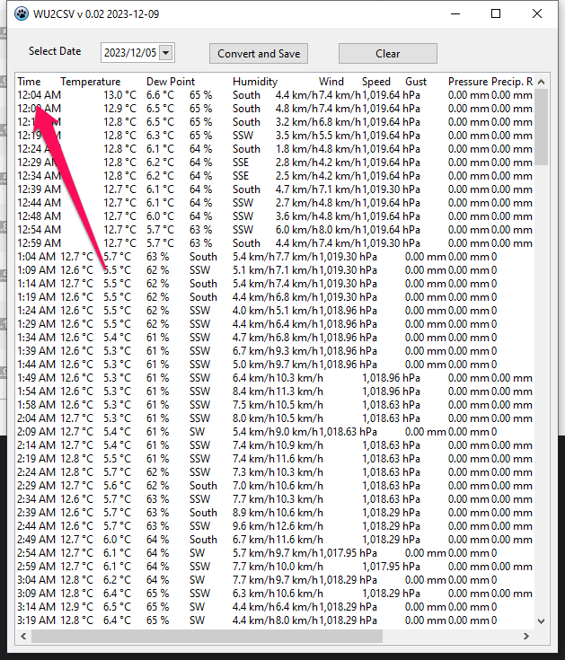

Tried it now using your program, but when I go to manually upload the .csv file it gives me errors, is this normal?
I'll attach them below in the screenshot

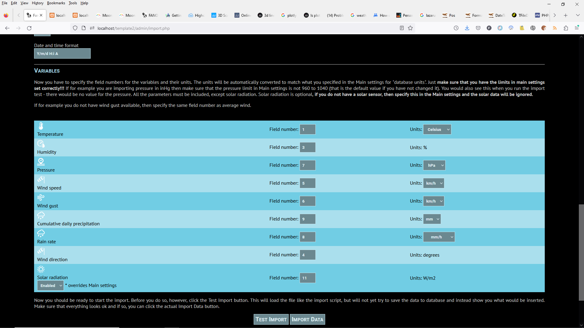

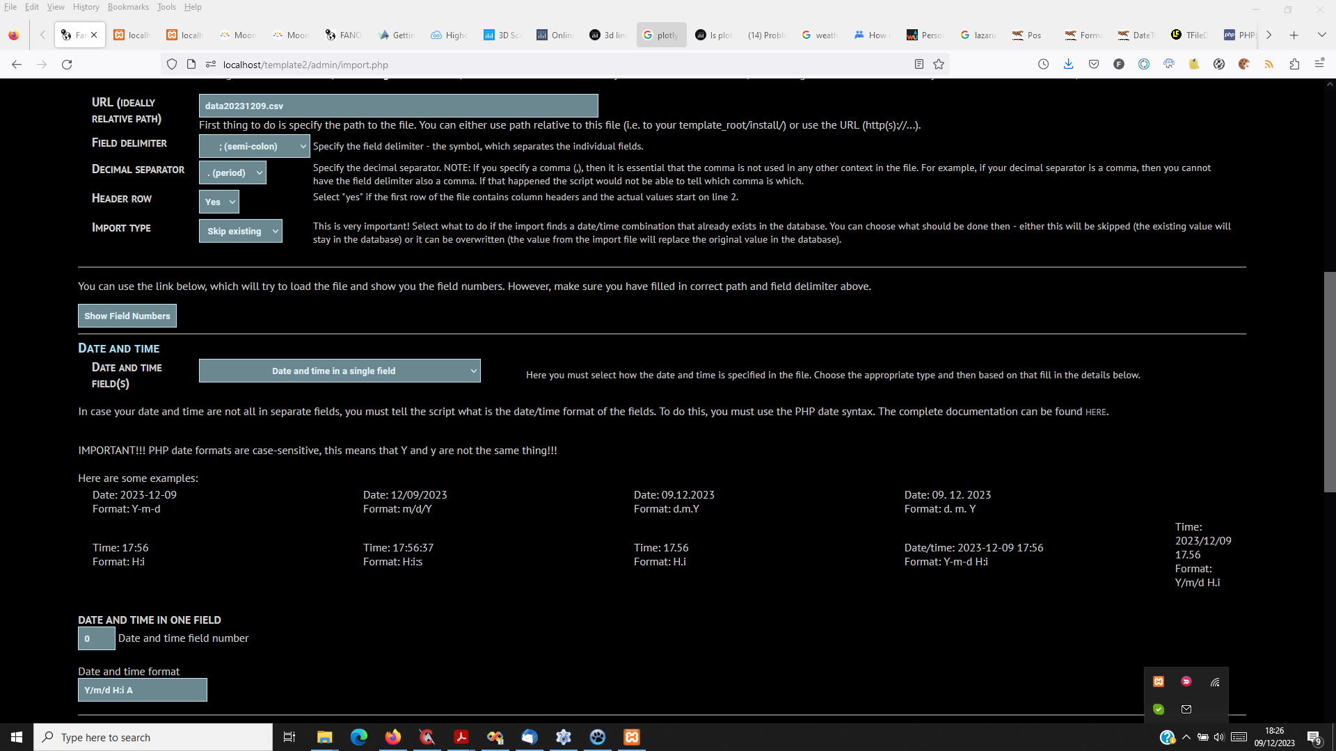

I have posted also the import configuration... but I can't see the post ( maybe I forgot to click the submit button after a preview ).
So here the configuration:

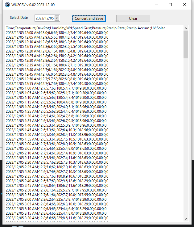

No the conversion isn't ok ( the rows do not begin with the date ).
When pasting the data, the first line should start with: Time
I updated the script as forgot the conversion of the 'South' direction
This is after the conversion ( 5th of December ):

Hi Davide
I just checked on the site and saw that the data imported from wundeground has a totally different layout from that of Meteotemplate, in fact I found some values that were out of line for December. Can I delete these days that we imported entirely, to avoid ruining my statistical data? Or can we solve it some other way?
- formatwunder.png (30.5 KiB) Viewed 15410 times
- formatmetetmp.png (79.05 KiB) Viewed 15410 times
