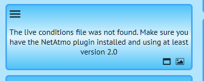

Re: new netAtmoNetModule ( netAtmoNet plugin companion )
This is the error message that appears.
However the plugin works correctly and the data is updated.
Initially, I thought that the cause was the removal of the block and plugin primitives ("netAtmo" and "netAtmoModules") to avoid errors.
But I think the cause is something else and I am not able to find it.
- netAtmoNetModules.png (14.8 KiB) Viewed 56482 times
I got the same error.
That message appears when the plugins/netAtmoNet/netAtmoLive.txt file does not exists, but in the case of tobydude I can see the file exists and is updated, and opening the block maximized ( https://fjærvollan.no/template/indexFul ... NetModules ) works.
My guess is that the php function that check the file ( file_exists ) fails for some reason.
In this modified block I removed this check ( which is also unnecessary ).
Sometimes something strange happens, for example on my notebook I have 3 different meteotemplate test sites running on php 8.2.4 on 3 different directories ( template, template1 and template2 ), same server, but on template2 I have the nasty message that the cache directory is not writable, even if it writable and files are created regularly.
Can't understand why...
Wondering why both of you have this problem in the same time ( the netatmo rebellion : - )?

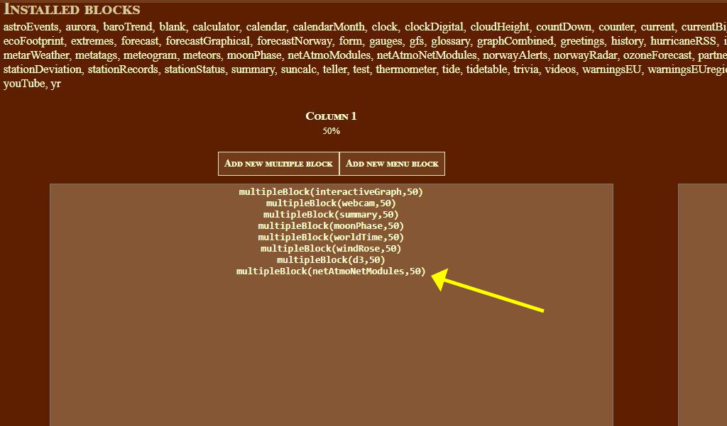

I got it to work. Not sure what I did.
Checked all (client id and client secrets)
Changed the block to "multipleBlock(netAtmoModules,50)" , saved, and then back to "multipleBlock(netAtmoNetModules,50)".
Sounds corny but than it worked.
Bottom left at https://fjærvollan.no/template/indexDesktop.php
