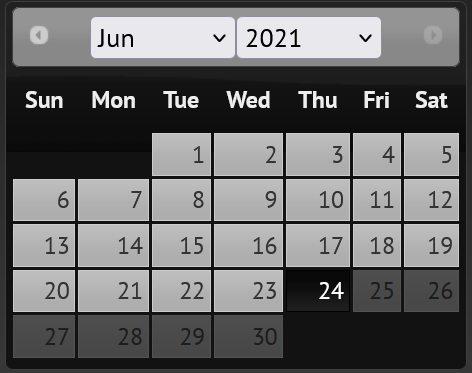

This is what the Date Picker looks like (greyed out after June 24):
date picker.png (19.8 KiB) Viewed 7110 times

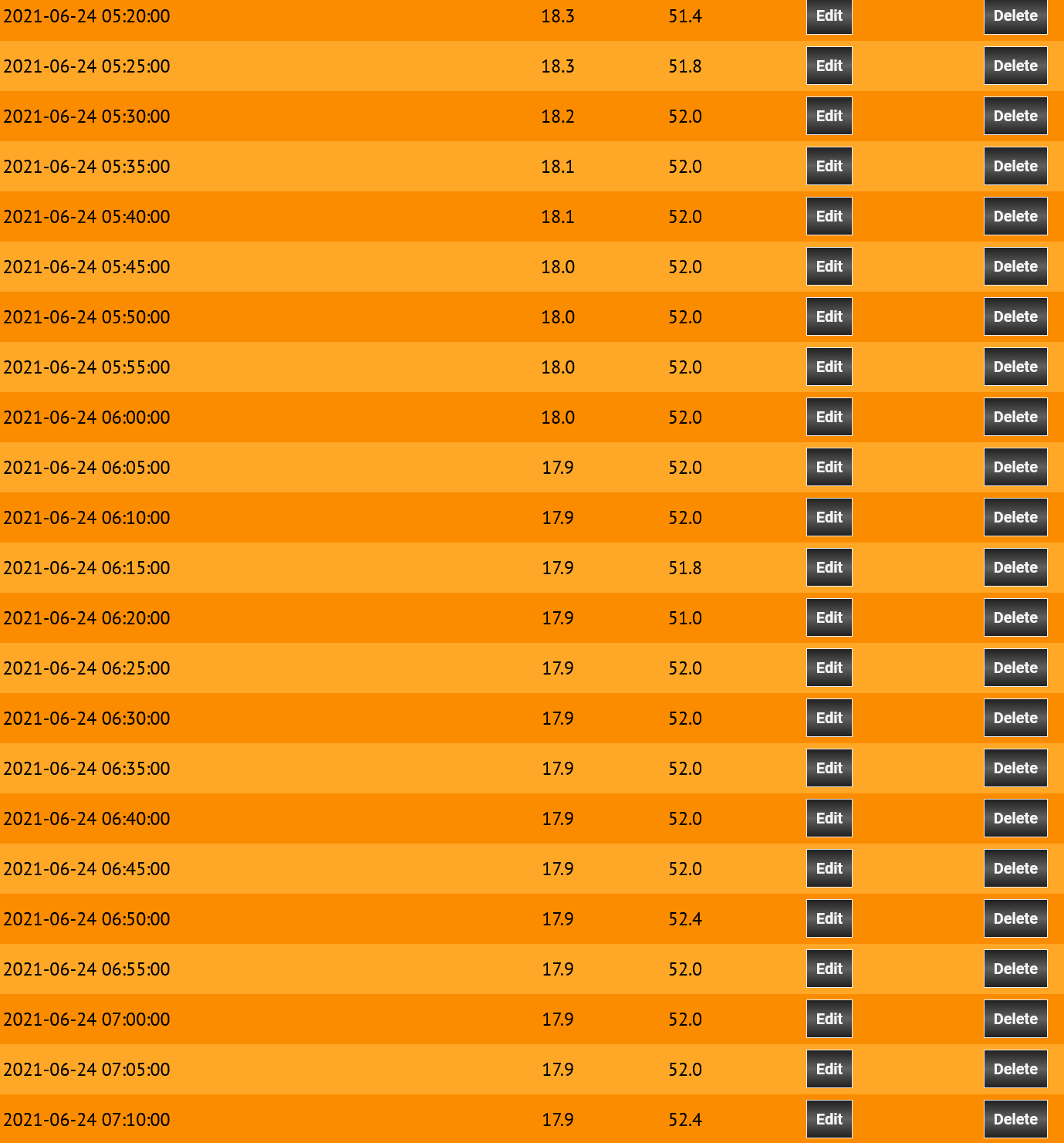

This is the data before, during and after the 0525h cutoff for plotting and tabulation:

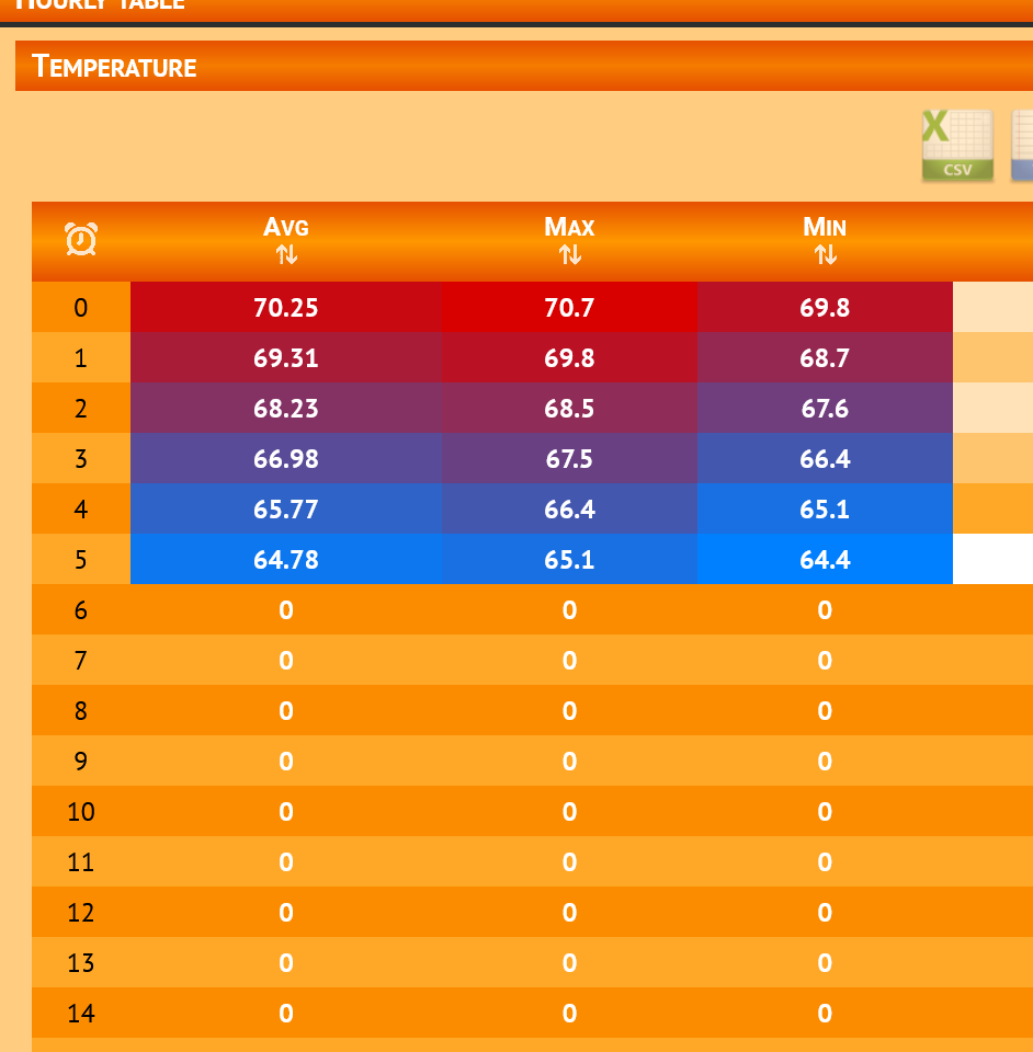

And hourly table, which does not show any values for hour 6 and later, even though the database contains valid data:
6-24 table.png (45.32 KiB) Viewed 7110 times

The image you posted refers to the table 'alldataExtra' ( I think ), but the plugin indoor data 'feeds' the table 'indoor'.
I think you should check ( with phpmyadmin ) if the table 'indoor' is correctly updated.
( I know the same data is fed also to the 'alldataExtra' table, but the plugin indoor data uses a different table, table 'indoor' )

@davidefa: You are so smart! The indoor table does not have any data beyond the June 24 cutoff. This gives me a clue as to where to track down the problem.
