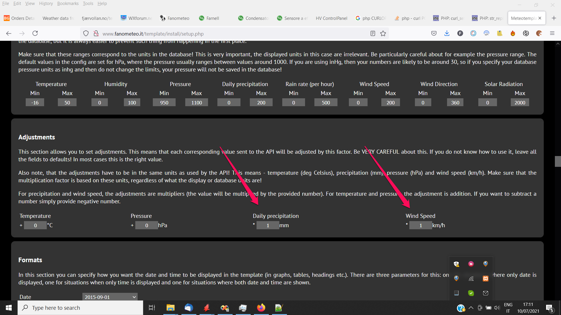

Can you also please take a look at my webpage and possible see why my wind and rain don´t show? :)
The wind and rain did show when I first installet netatmo, a few days ago. No it don´t.
I use Weather Display for uploading weaterdata. I also upload weather data to a different server server via WD (for an other weather station).
In WD , I also upload to Netatmo via "Weather station type" setting.
Any idea why the wind and rain dont work?

Check in your meteotemplate control panel -> main setup that the rain and wind multiplier are set to 1.0 ( or something like that ) but not to 0.0

Post by tobydude » Sat Jul 10, 2021 3:27 pm
Thank you! Look like it works now. :)

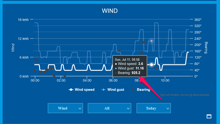

Ok, it works... but I made a mistake in the block interactiveGraph ( I noticed it looking at your page: the bearing indication is totally wrong )
Updating the block should fix it ( the data in the database are correct )

Before updating the block:
I just got the Netatmo station and placed the wind gauge on the railing on the step, before mounting it on the roof-top.
I put a small towel under it an last night i discovered that the wind somehow blew the towel over the gauge. :/
Last night I also was thinking that the wind direction was wrong and I thought the towel did it.
If so, sorry for the ekstra work I caused you.
Re: Weather data from Weather Display
Post by davidefa » Sun Jul 11, 2021 10:15 am
I made a mistake ( well... at least one ) in the interactiveGraph block: I multiplied the wind bearing for the same correction applied to wind speed ( 3.6 in your case, when displaying wind speed in km/h having wind speed in m/s in your database )
Having a wind bearing of 925.2° is 'a bit too much'... 257° should be 'more appropriate'

Post by tobydude » Sun Jul 11, 2021 10:36 am
Updatet on webpage.
