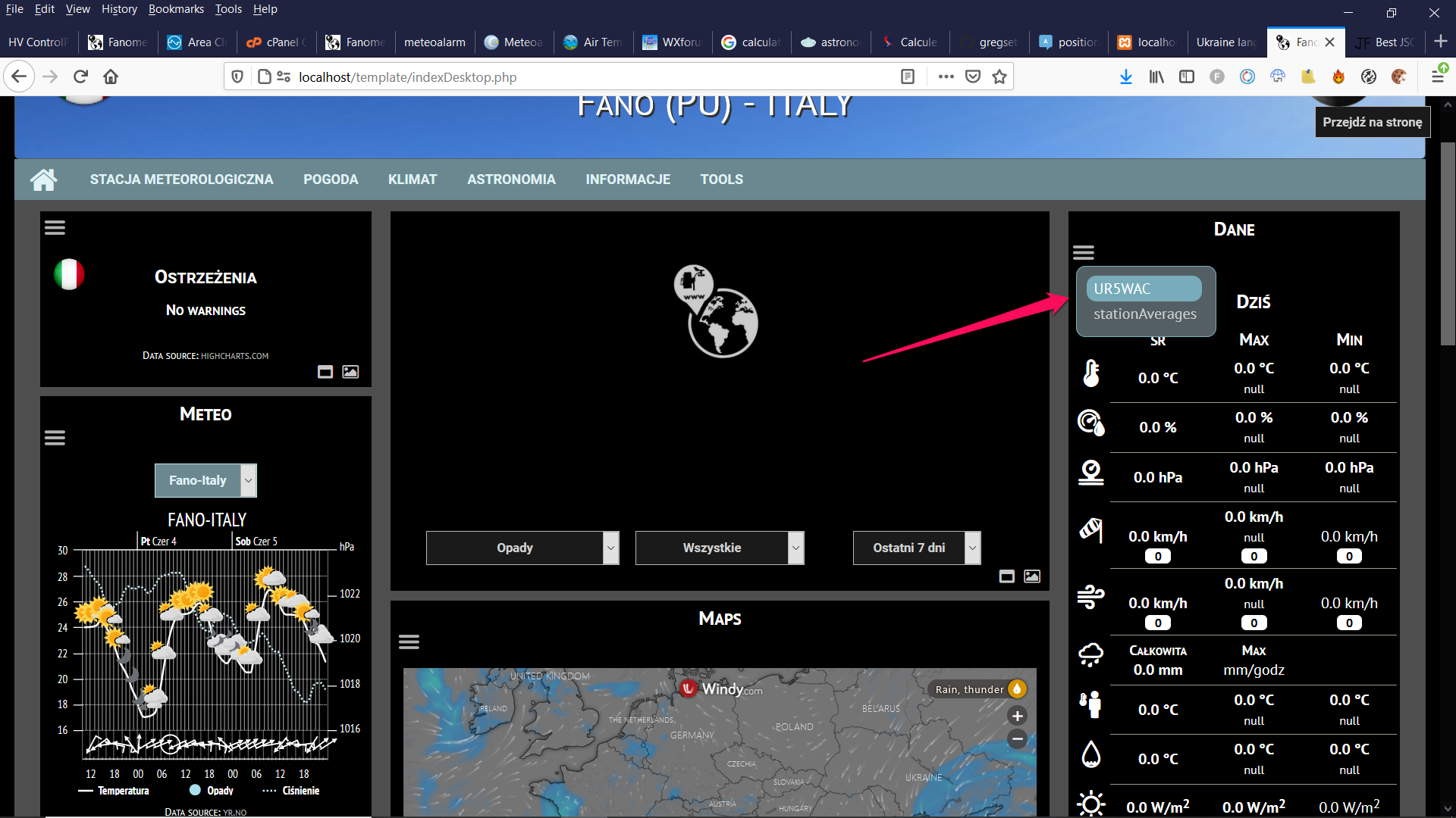

I ask for help.I need to translate a language file.For training, I used the Polish file pl.php, which works correctly.
In the line "stationData": "Dane Stacji" replaced with "stationData": "ABCD".
After such a change, the site stopped switching to Polish, only to English.
The translation was done using EditPlus.
Please tell me how to correctly translate into another language?
With all respect, Andrey
My site: http://www.dragana.lviv.in/template/indexDesktop.php

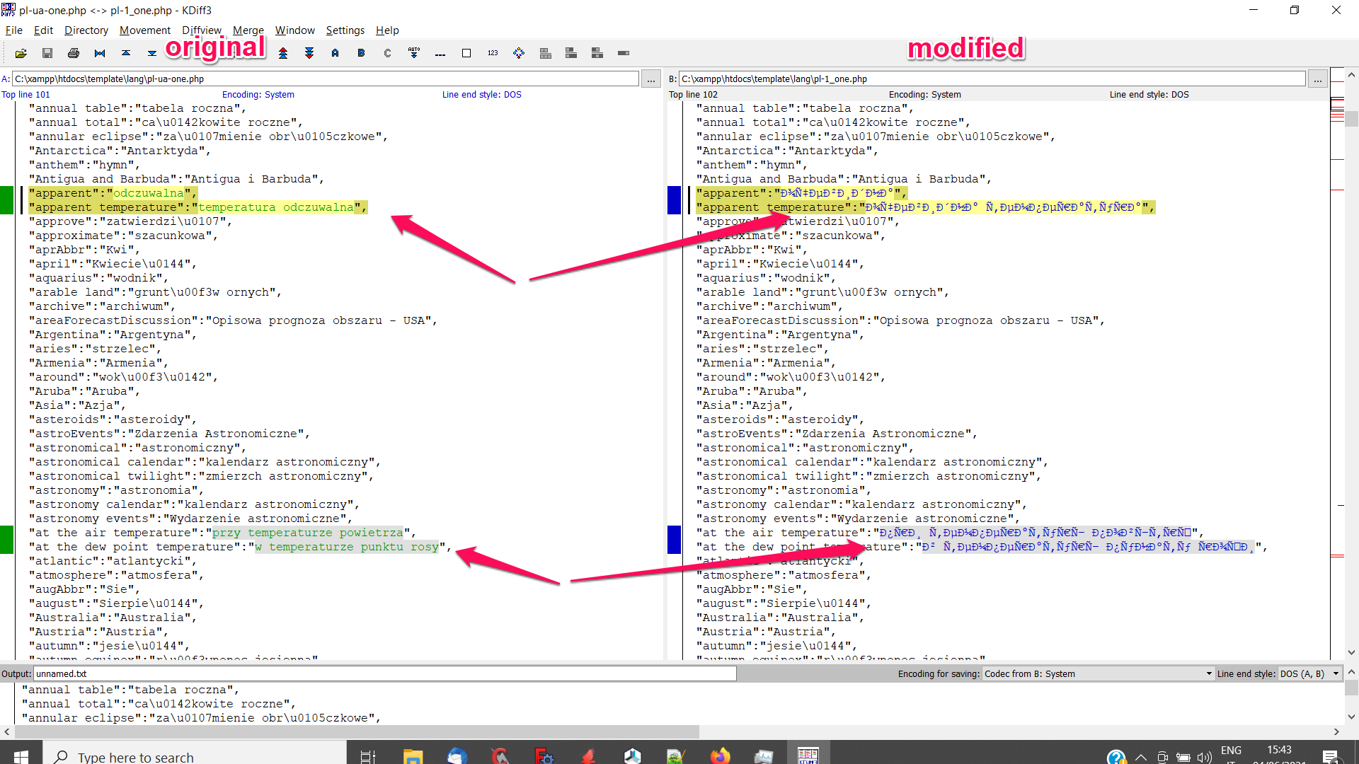

Re: Ukraine language
As I said you are doing right, but the editor you used messed with the file encoding ( or something like that ) during your editing ( see attached image ), after removing the 'garbled' text your file is ok.
So repeat your editing from the beginning ( keeping encoding as utf-8 without bom ).

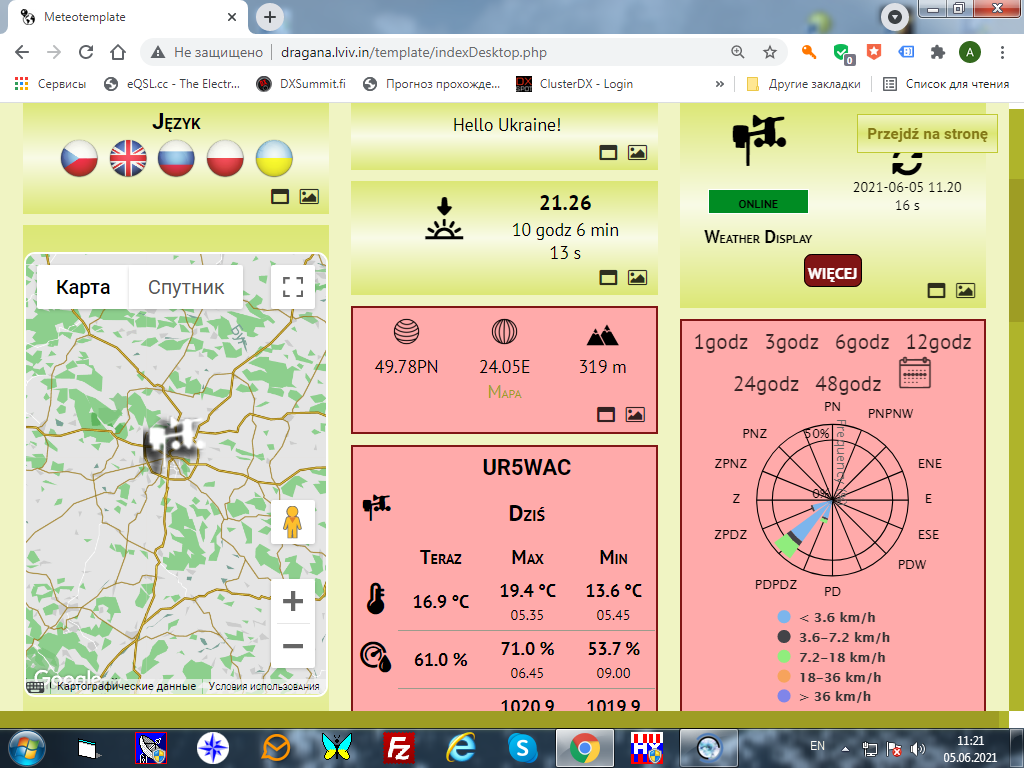

Many thanks to you Davidefa !!! You helped a lot and understood what we are doing. My friend UR5WAC helps me with translation into Ukrainian. My callsign is US5WAC. We will still contact you with questions. Thanks for the competent consultation. 73!

Dear David! My friend, a radio amateur, made a translation into Ukrainian. The file does not work on the site. Check errors and fix them. Send the corrected file. If the translation works, then you can put it into the template via Jachym.
- ua.rar
- (29.39 KiB) Downloaded 1098 times
Here the file corrected ( a few 'imperfections' : quotes not correctly closed, missing semicolons and incorrect escaping )
- ua_1.0.zip
- (28.41 KiB) Downloaded 1113 times
