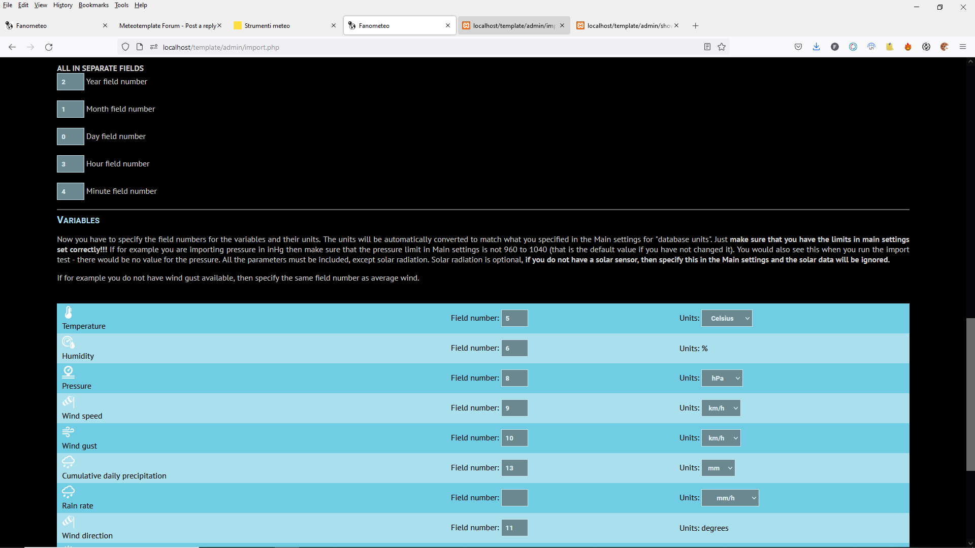

i would insert weather data from Weather Display logfiles into meteotemplate db.
Every WD logfiles contains 44640 rows (1*60*24*31).
I've tried to use meteotemplate import data menu but this process ends after only 3 days (4320 rows).
What can i do to import the entire logfiles?

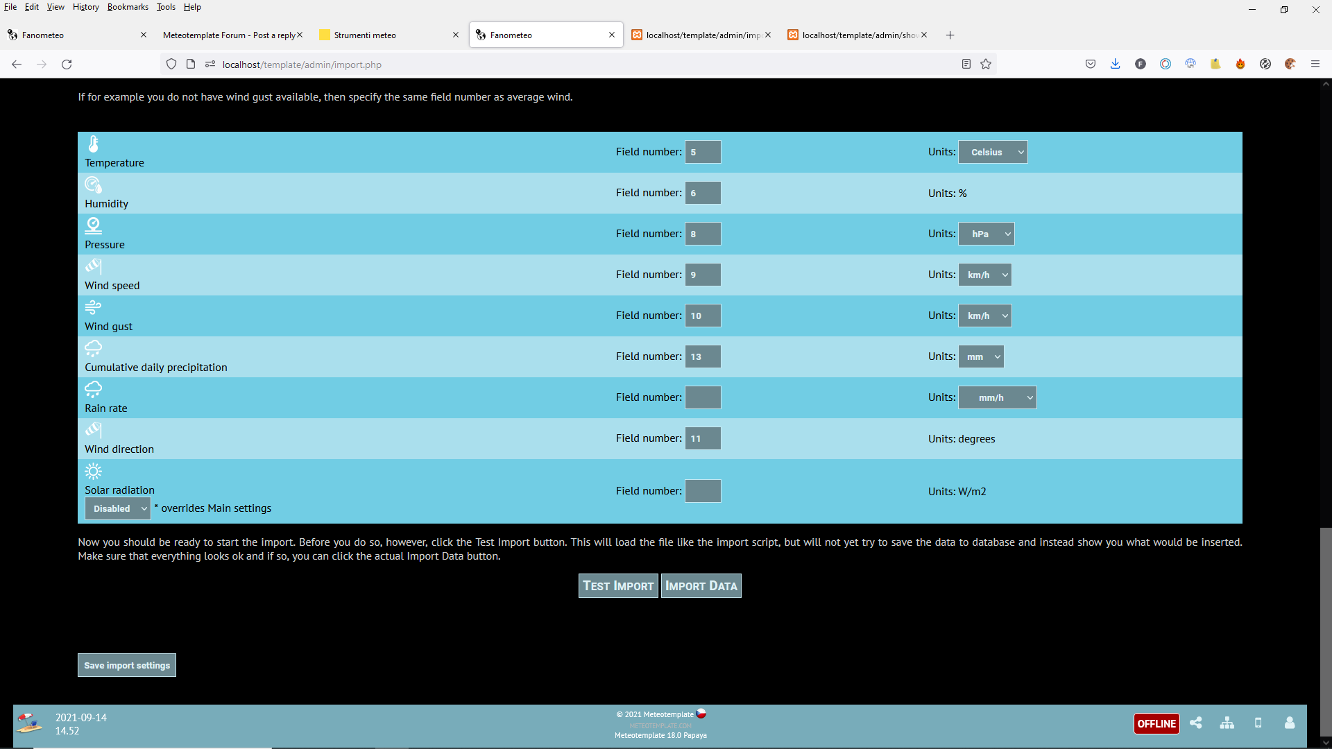

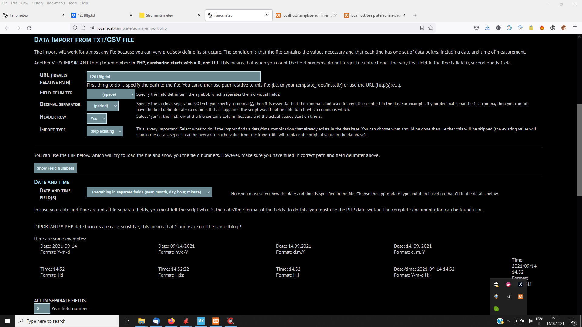

I imported correctly both files using following settings:
If this does not work for you we need to understand why the script times out ( or use phpmyadmin for the import process, a conversion of the data is required )

Thank you so much for your reply and support.
Strange.
My settings are the same except Field delimiter.
In my case is set to "tab" while your is "space"
With space i've a lot of errors because month values goes empty.
Same stop after three days of imported data :(
Alessandro

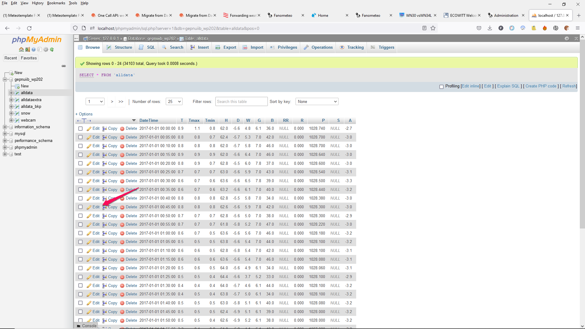

i_fiorentino
Posts: 82
Joined: Sun Aug 27, 2017 11:31 pm
Location: Pistoia, Tuscany, IT
Re: Import data issue (timeout)
Post by i_fiorentino » Sat Oct 16, 2021 12:26 pm
Thanks for reply!
Unfortunately i've not "edit" field on every db row.
How have you done?
Ty,
Alessandro
Post by davidefa » Sat Oct 16, 2021 1:31 pm
I think you have to setup these things: ( particularly set DateTime as primary key ) type, null and default columns as shown
