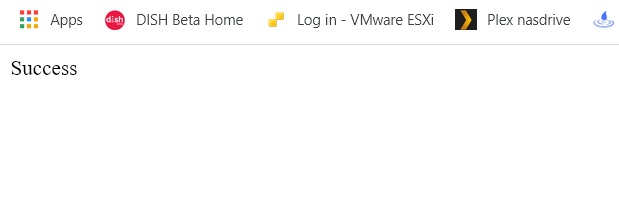

Post by spd2612 » Fri Oct 15, 2021 12:10 pm
I run that command and it returns SUCCESS

Post by davidefa » Fri Oct 15, 2021 12:15 pm
Check if the cache/apiLog.txt was generated ( it should contain the data you passed )

Post by spd2612 » Fri Oct 15, 2021 12:25 pm
yest its there
Authorized access.
Current date/time: 2021-10-15 08:23:42
api called by http
update U: 1634300622
my site does run in https
there are no url redirect except on the index desktop php
