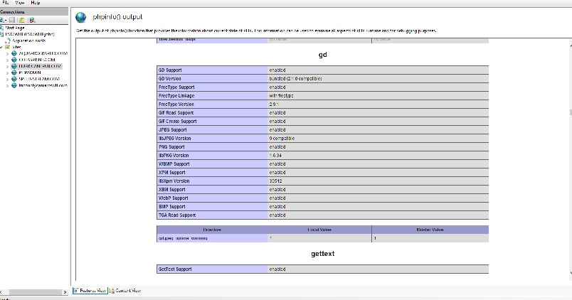

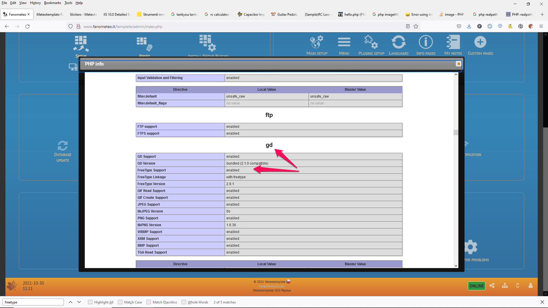

You could try in line 4:
$font = realpath("./Roboto-Bold.ttf"); // font ( need to specify font with path )
P.P.S.
Another thing to check ( don't remember if already checked ) is freetype support in php:
P.P.P.S.
As a last resort you could use the imagestring function ( you already found working correctly ):
use imageloadfont to load a bitmap font ( you need one font for each size used ) and write it with imagestring.
This is without antialiasing so the look could be a little 'pixelated'
- freetype.png (122.5 KiB) Viewed 23045 times

Re: Stickers
well no text displayes on hello.php
I changed the relitive path on 4 no change
The URL to that font is https://hurricanepub.com/plugins/sticke ... o-Bold.ttf
it wil try to download it
GD looks good
What can I be missing
https://hurricanepub.com/plugins/stickers/hello.php
GD looks good
P.P.P.S.
