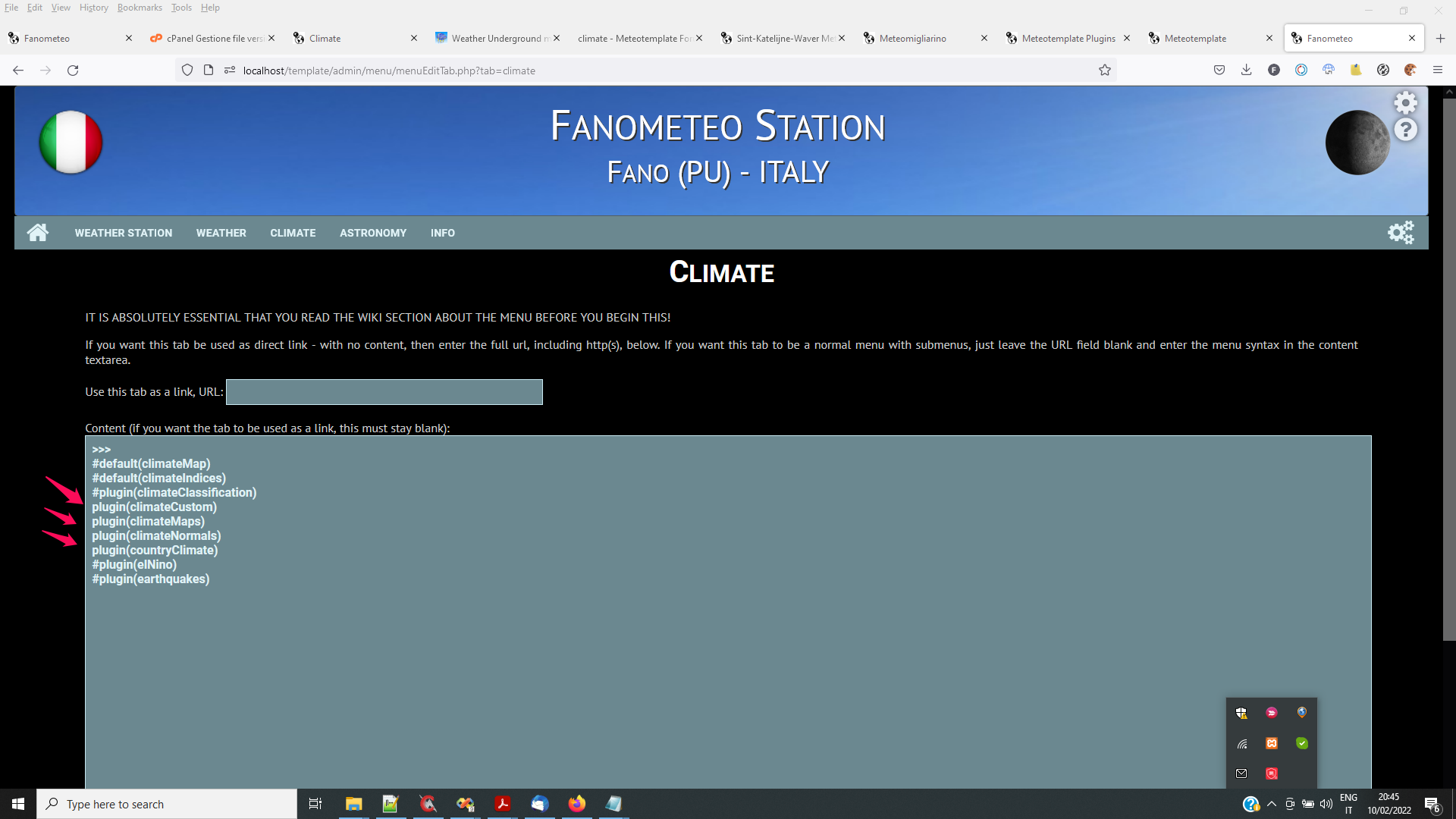

Your plugins are installed correctly ( https://www.sint-katelijne-waver-meteo. ... /index.php ).
You have to edit your menu entry:
#plugin(climateCustom)

Re: climate
In the menu setup -> climate edit ( you forgot the # in front of 'plugin' ).
If you installed the 'stock' meteogram and gfs blocks, you should update to the latest version available in the forum ( search for 'updated meteogram block' and 'updated gfs block' )
- menu1.png (216.77 KiB) Viewed 5228 times
- Posts: 225
Re: climate
sorry, did not see my # typo..
